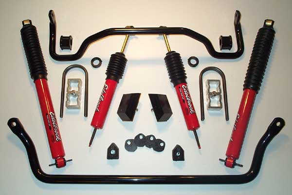

There is no easy way to get 2 1/2" drop and still get the camber right. It can be done, but you need to rework the a-arms, torsion bar keys etc. There is no "kit", it is custom affair. I believe JamesT did it. His is very low and it looks good, I do not think it was easy. I have not heard of a hybrid lowering set up (bags in front/blocks at rear). I do have some 3" lowering leaf springs (Belltech) and 3" lowering blocks (Chasis Tech). The ride quality is better with the lowering block set up. Bottom line, there is no easy way to lower an Explorer more than 2". There is a big price gap between the standard Explorer lowering job and a custom air bag job. A standard 1.5" drop will give you a lowered look, improved handling and a price you can afford. We have the Lowering Kit, Special Edelbrock Shocks, Bumper Kit and upgraded sway bars at Explorer Express.
