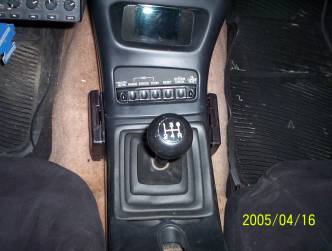

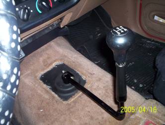

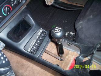

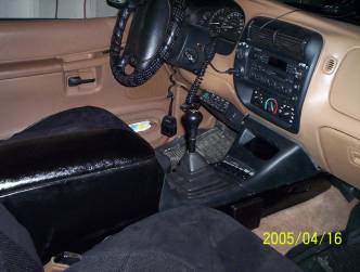

Thanks. I guess to better describe what I meant before. It looks like it would go up more than forward when you switch into gear.
Here are 2 pics..the first one is when it is in 1st gear and the second pic is when it is in reverse.
