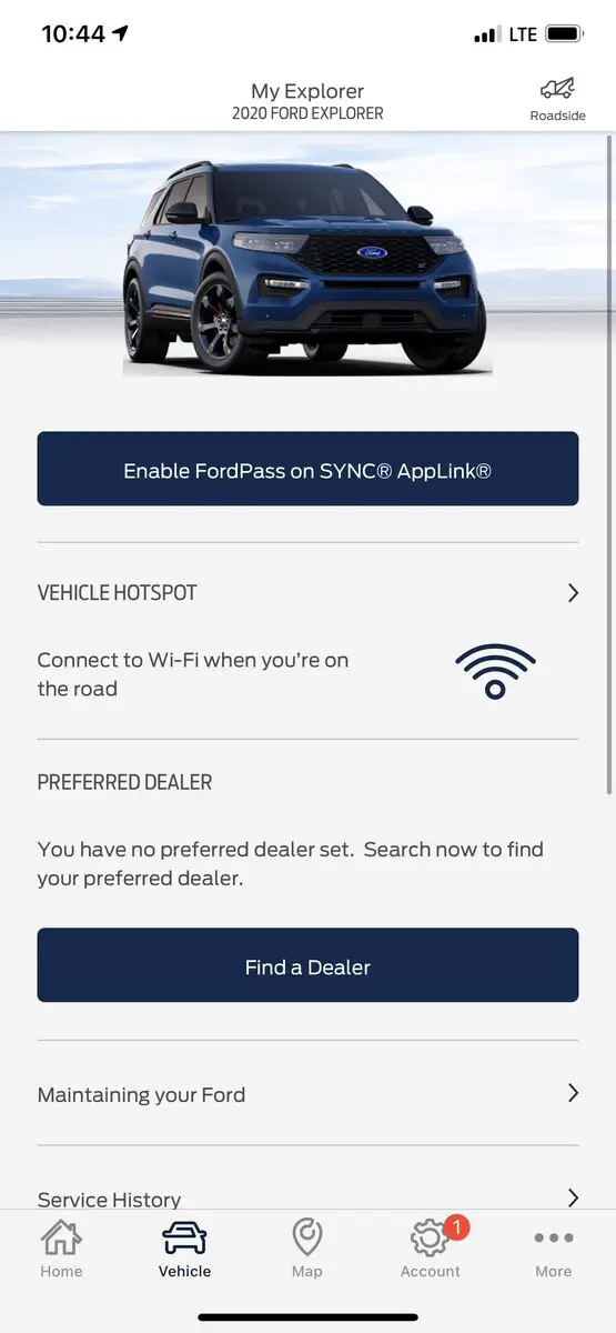

I just received my ST on Tuesday and I don’t even have the activate function. Did the master reset, did the multiple deletes and on the Ranger forum they have a set process to follow which also didn’t work. So I reached out to the fordguide techs and they have confirmed that Ford lost this feature with iOS 14 for vehicles produced after a certain build date. I’m guessing it’s a different modem version. They said the engineers are working on an app update and once you see the new version in the App Store it should be resolved.

I just did the update and same here. I still can’t get the “activate” button to show up. I’m going to try the master reset again and see if that works. What did they say when you told them you have the same issue? I saw there is a TSB for reprogramming the TCU. I’m planning on taking mine in for service to look at.

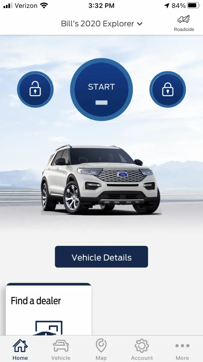

Well, I checked my FordPass today and the engineers did their job. The remote buttons on the app are back and the vehicle details are back, fuel level, tire pressure, etc. Thank you FMC.

Good to hear. Mine is in for service. It was supposed to be a couple of hours worth of work and I was to get the ST back yesterday. However I am currently sitting in a rental Elantra with no ETC.
I’ll post what they did when I get the suv back.

I got the car back, they did SSM 49084 which is to reprogram the TCU. Still no luck. When I add the vehicle to the fordpass app I do not get anything related to “activate”. I only get the following pic.
My sales guy said he will reach out to Ford directly and see what the next steps are.

Here’s my screen shot showing all working. iOS 14.0.1 on iPhone 7.
