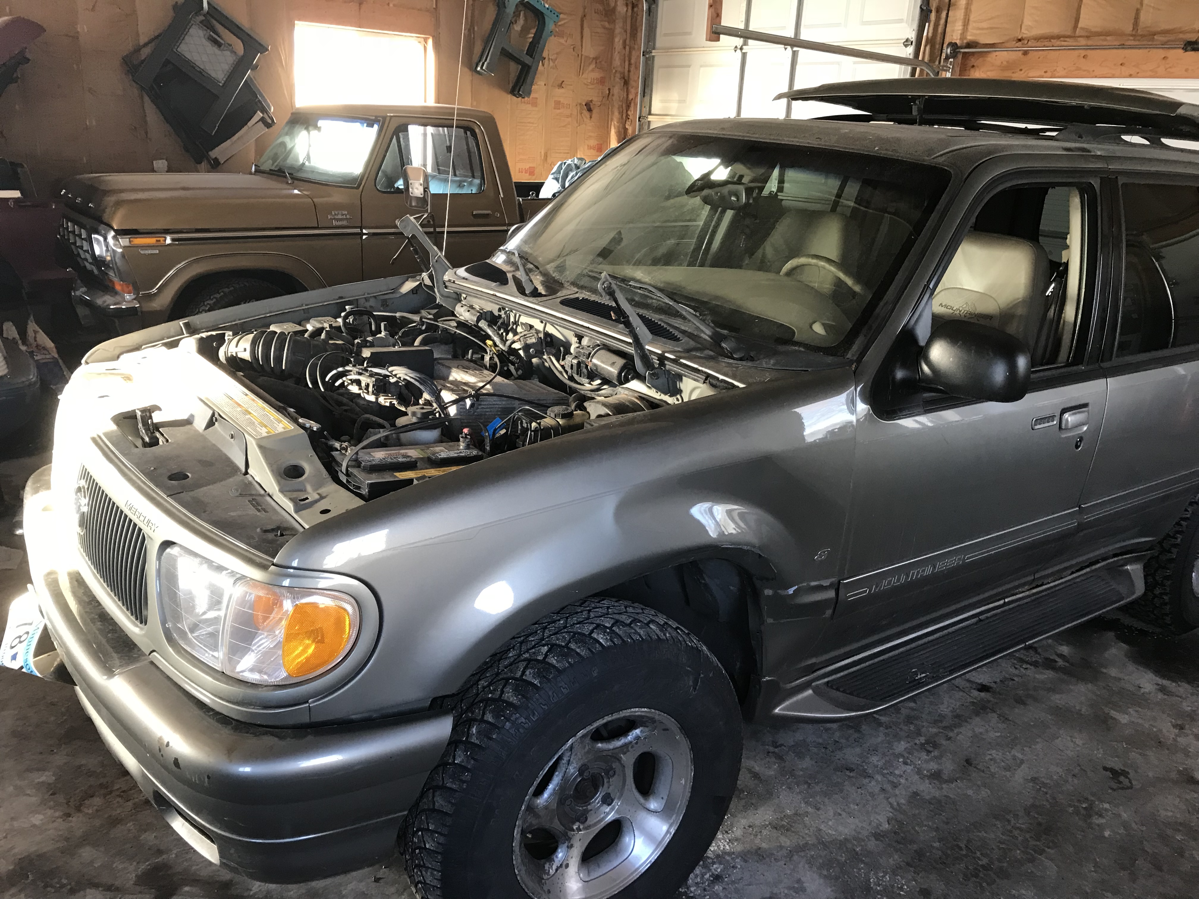

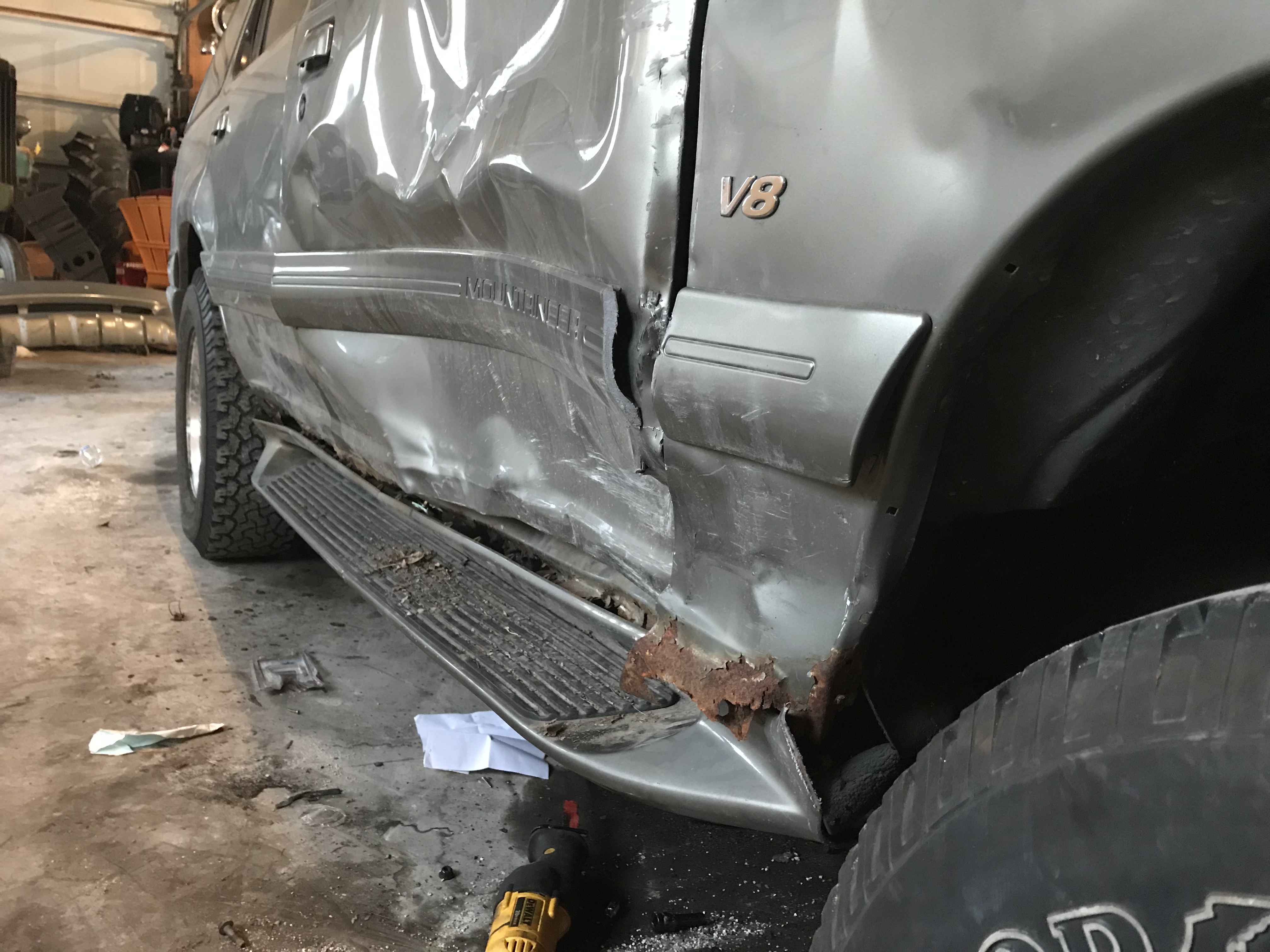

I want to do this! I’m going to be looking at u pull yards for a limited. I swear they trying to crush every single 5.0 truck up here! I feel bag taking apart the green one. But it was hit hard on the passenger side. I swapping the grill and bumpers to the black one. I have them off and inside.

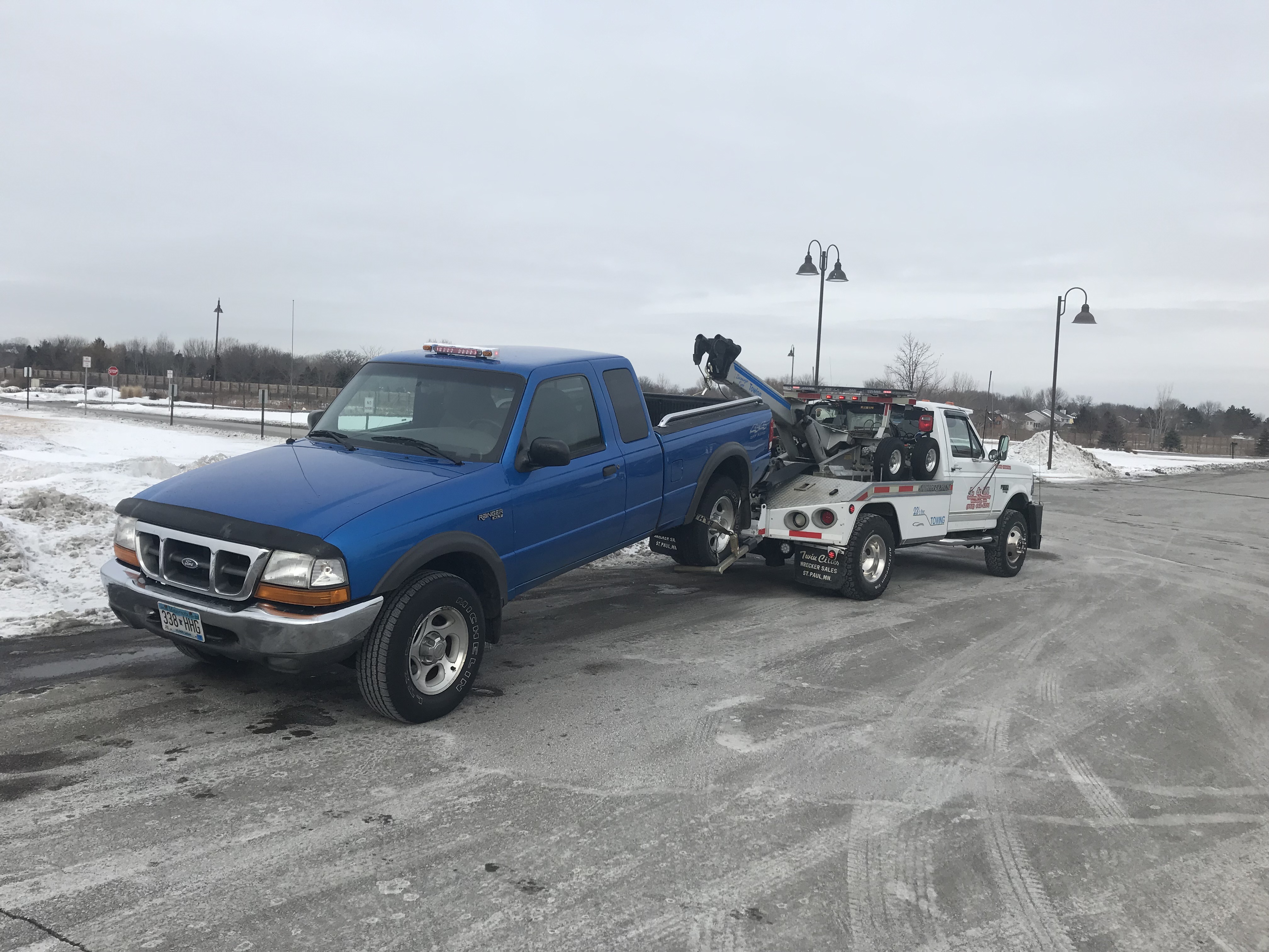

Doesn’t look too bad from here. But it pushed in the floor pan. The motor is going into my blue Ranger.

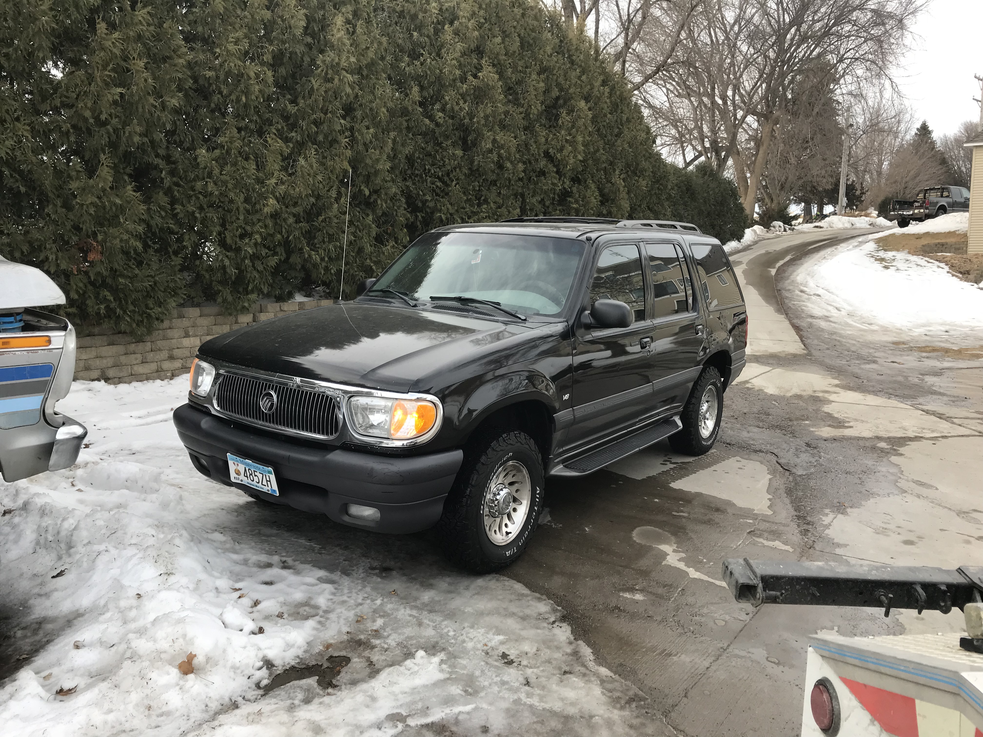

As for the black one it needs rockers and a little bit of help on the rear wheel wells. But still fixable. Now it has sentimental value after 5 years. It’s been the most reliable truck I’ve owned. It doesn’t like to sit. After about 2 weeks the pats kills the battery.
