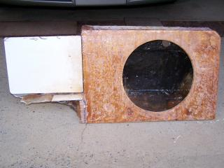

Sound deadener behind the seat.
Fiberglassed the factory sound damping material for shape.
Retained the soft insulation to prevent rattles, and 'glassed a plastic push pin into place to keep the box from moving.
Fits
Amp rack added.
Test fit.
Carpeted and all panels installed. Awaiting the Rockford Fosgate Punch 12" shallow mount woofer.
Center console features the amp's on/off switch (on the blue lead), and the Punch bass boost knob.
Tweeters in the dash.
Seats still fold down and the jack is still in place with a protective fiberglass divider for the amp's wiring.
looks nice, is the box volume matched for the speaker, or just made to fit the space of the opening?
I believe it ended up 1 1/2" shy on one side to get me where I needed to be.
