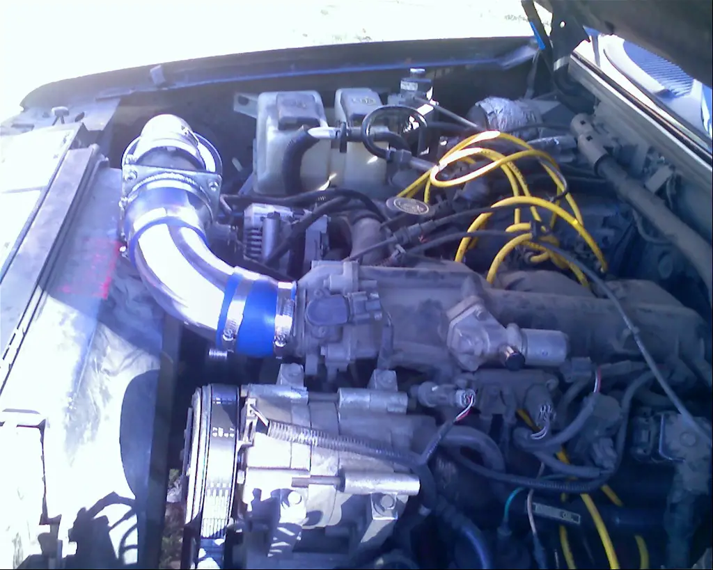

Turns out he was wrong. Or at least they ordered the wrong kit. The K&N 57-2758 kit didn't fit because the main pipe was about 3" too short, the bend to the throttle body was 45deg instead of 90deg, and the hose to the throttle body was about a 1/4" to large. Other than that, with some effort and more hose and clamps I might have made it work.
The speed shop ordered me the 57-2757 kit and hopefully it will be right.

Got it installed and am happy with it. Looks great. Frees up room for other stuff. Not much performance change but attacking the exhaust next.
