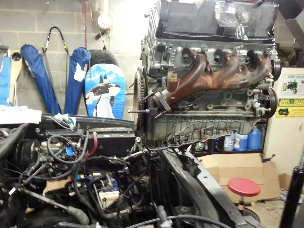

Sure enough I already have the inspection cover, but I am clearly missing something between the engine and the transmission, because the flywheel is visible. It's probably some type of 1/16" thick piece of steel plate. It's a cover or a spacer of some kind but not being able to see it, I have no idea what it is.
I have photos of the area if needed.
Can anyone give me a clue as to what this part is? And how mad should I be that the bafoons lost it/ forgot to put it back?
By the way, when then were bolting up the flex plate, they mentioned that the bolts were 1/16" too long and scraping, so they had to get new ones. I'm sure this is the reason why.
Here's a link to the images. I was going to wait and pay for a membership so I can host them here, since this place is well worth the cost. But since there's been interest already, here's a set of 4 photos of the open flywheel:
https://imgur.com/a/HAw0C
Sorry about the bad angle, but this is the only shot I have that shows the plate:
Looks like you're having fun! Thanks for the shot. I'm beginning to understand what's involved in replacing it. What do you think could result from leaving it off? Aside from dirt and debris getting in there. Or is that a huge concern in itself?
I guess I'm just trying to plan for my torque converter upgrade. If it needs to happen ASAP, or at my convenience.
I just realized you have a V8. Mine is a 4.0, so the shield may be different anyway.
It may affect the starter spacing. Does the starter engage OK? The torque converter probably has enough over-travel going back that it will just sit a little deeper in the transmission. There is probably enough play in most everything else (mounts, linkage, etc) that alignment will be OK.
