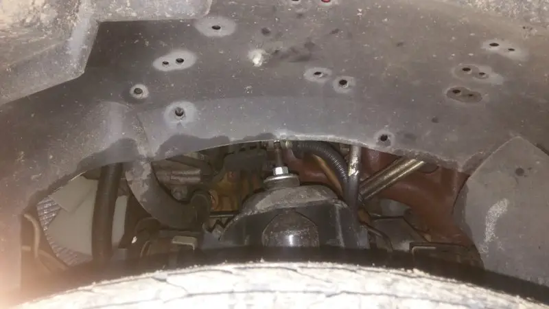

I have a 2005 s.t..im just wondering if im missing some type of splash shield on the front end..when i look into the wheel well i can see the complete engine block on both sides also alot of empty holes..i can see all of the suspension..please help..this dont look normal
For some reason Ford put either short splash shields on the rear only (like on my late production '01 ST) full splash shields like those on Gen II regular Explorers, or even no splash shields on ST's. You can add them if you like. The holes are there. You can get full shields from RockAuto.

I had to add them to my '05, but only on the passenger side. The drivers side hod one in place. One small advantage I noticed was that is was a little quieter in the cab after I installed it.

I read somewhere that the splash shield was left off to help control temperature in engine compartment. After I put mine on I did not notice any change in temp, so....

I think they help keep dirt, dust, debris, etc out of the engine compartment...
X2 on the Rock Auto splash shields. Perfect fit on my 2001, both sides.
I install my splash shields with plastic push-rivets. This makes them easy to remove/reinstall. Dorman makes the push-rivets (don't recall the size I used, but I did need to increase the stock holes in the plastic inner fender 1 step-drill size. Most auto parts stores carry the plastic push-rivets on a Dorman fastener rack.
Appreciate everyone's advice..ill be buying the rockauto brand...the junkyard had zero possibilities..cant believe it left the factory like that..totally exposed engine block and wires...
