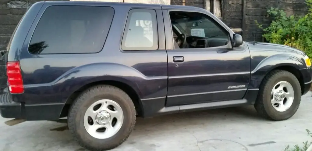

Recently started working on the GF's 02' sport since she was jealous of me always working on my Jeep. So far I have removed the roof racks, dropped the torsion bars 2.5" and installed a 1" spacer in the leafs. Since they were sagging anyway it leveled out the ride and it looks a lot better. Handles much better now. Also replaced the sway bar links (plastic, really? -_-) with heavy duty metal ones since the drivers side cracked all the way down and snapped the bolt. Next thing will probably be wet-sanding the hood and respraying a clear coat on it since its all desert-cracked. I've owned 2 Fords before (94 T-bird LX and a 92 F250 beast with a 351 crate rv cams/headers, 6" lift w/ 35's on 3.55 gears and a 4 speed lol). Looking forward to checking out what kind of mods you guys do and all. Here's a pic of it after I dropped it
