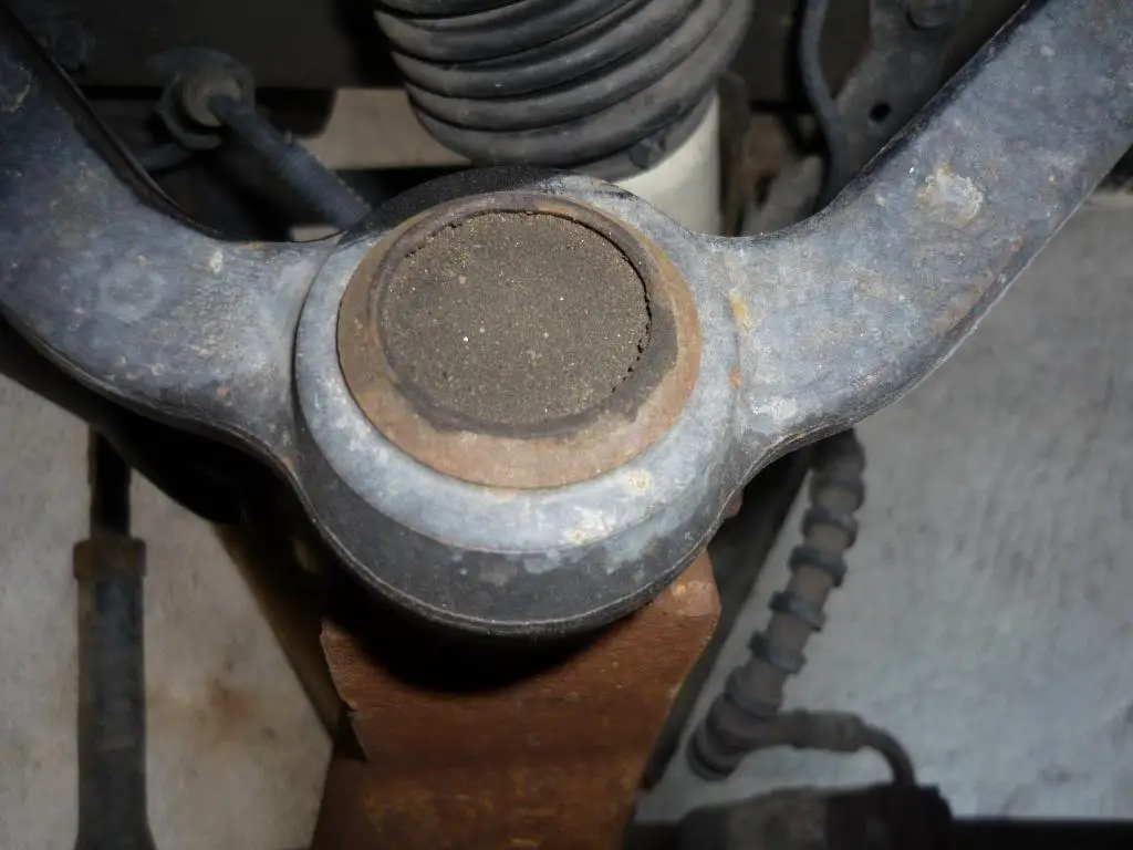

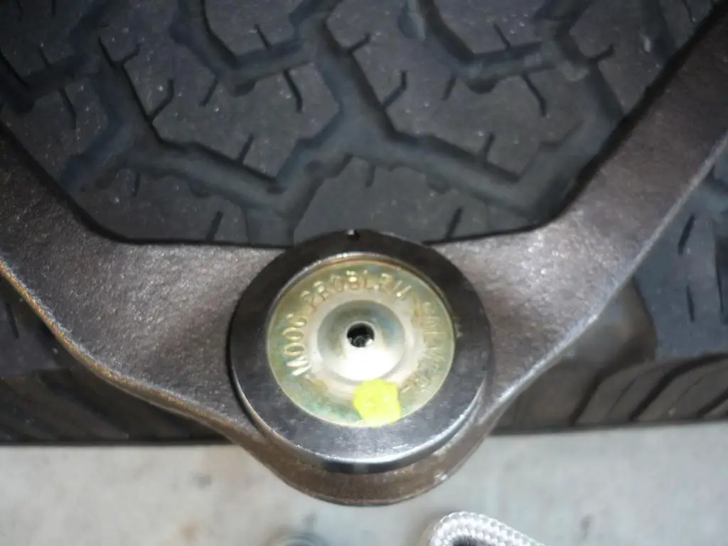

Just thought i'd show the difference between a non-replaceable BJ and a replaceable "problem solver" BJ, for future reference for others.
Non-replaceable
Replaceable
Comparison

Well i'll be....i got the right UCA today and it has a problem solver replaceable BJ! The package list says it's part#80068, so i guess the description online is wrong.
