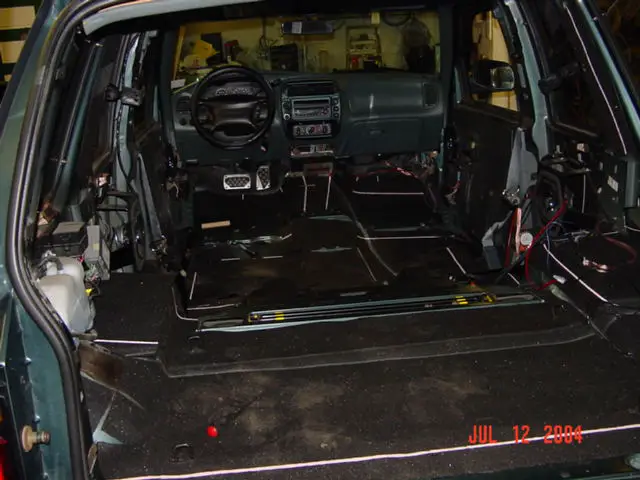

Haven't had any experience with the spray stuff, but I have read mix reviews about it. Check out Raammat BXT. It is made of butyl (not asphault), and it is a lot cheaper than Dynomat. I would also recommend getting some Ensolite to put over the deadener.
Here is a link that may help you choose a deadener:
http://www.sounddeadenershowdown.com/
Also, here is a pic of my truck with the Raammat installed, before the Ensolite:
might want to try using some expanding foam also in your hollows
Didn't see the pic, but I got similar!!
