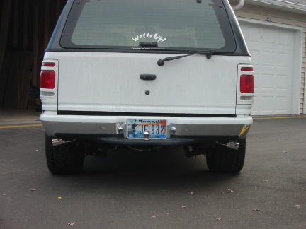

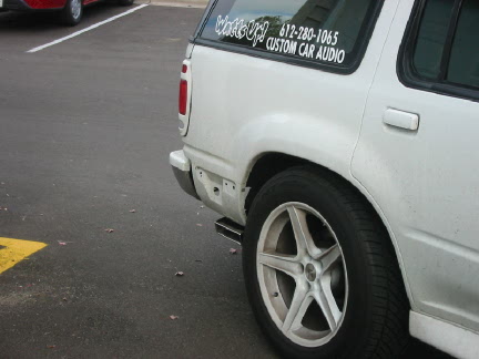

i have a v8 but i know that if you did this set up with the same muffler on your 95 ohv it would sound straight. the muffler is the dual in dual out 2.5" magnaflow (you should stick to 2.25" pipes though- just have them welded to fit them into the holes)
the magnaflow is quieter than 40 series too
