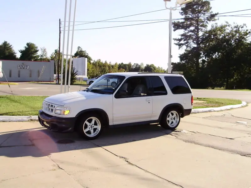

ok so my dad swapped out stock 2000 mustang rims for some huge ones and the old stock ones mount up nice on my 98x and i like the look of them,
i was wondering if the stock mustang tire on the rim would be able to run on the x because im a little worried about the weight of the x on the tires.
if anyone knows if they don't support the weight what would be the right tire size?
oh and ive got the notorious rear end sag and was wondering if helper springs cure this because my dad for some reason thinks i need new springs.

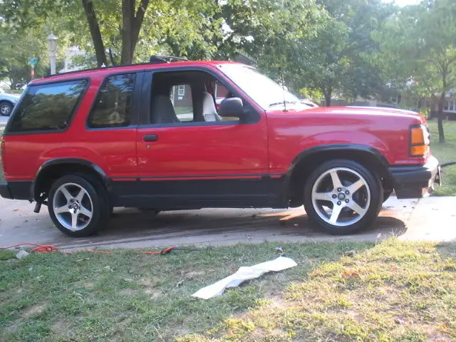

Am I the one that you are talking about if so yes they do fit nice. I had mustang rim on both my 1st and 2nd gen Sport :D
And I have Saleen wheels on mine...

yea the rims i got are 17x8, just wondering what tire sizes can fit underneath the explorer without rub or weight issues.
17x8 should fit nicely.
well I have 315-35-17 on rear , 245-45-17 on the front :cool:
I am VERY low in the rear, tucking a bit of the rubber, and the WIDEST you can go there is a 285....so I have 285/50-18 in the rear, and 255/55-18 up front.

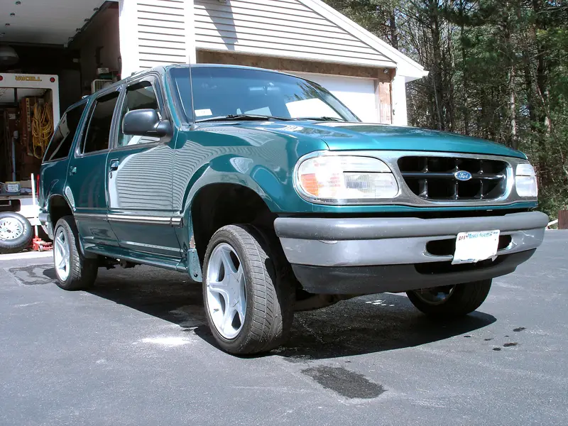

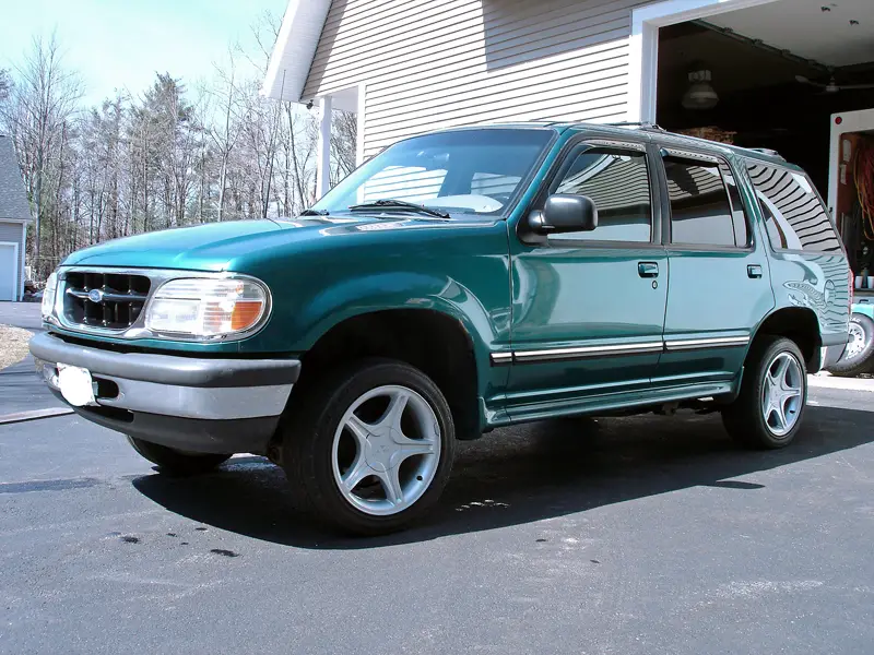

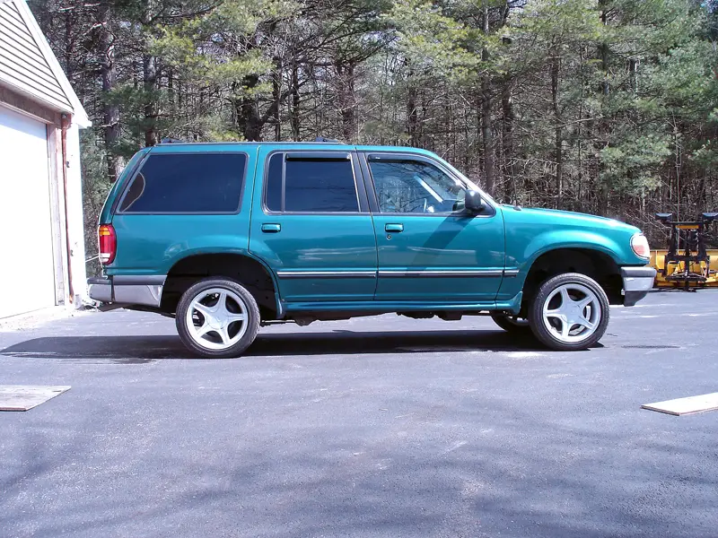

well i finally put them on, drove around for about a week on them and i didn't like how the tires looked. they looked like they were way too small for the x so i swapped back to stock. i think im gonna put some big summer tires on them later on once i put on warrior shackles and do a tt.
mustangs:

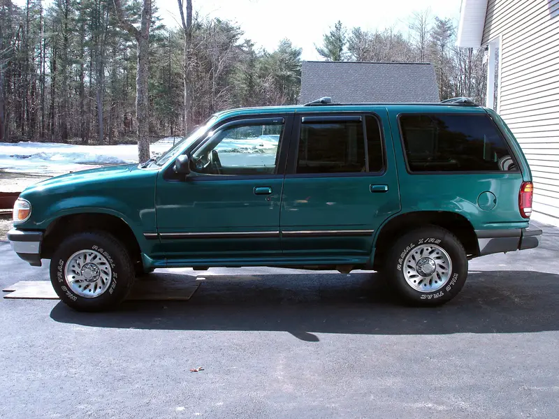

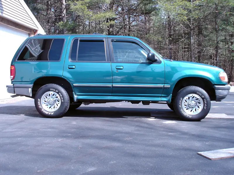

stock rims/tires shined up:
ps. i had great mpgs with the mustangs on. kinda wanted to keep them on just because.

That Mustang wheel/tire combo was WAY too small for the Explorer.
You could have used the Explorer TIRE, on the Mustang WHEEL. That Mustang combo was probably 2-3 inches shorter than the stock Explorer combo.
Ryan
I don't think i can use the stock x tires on the mustang rims. stock tire is 235/75/15 mustang rims fit 245/45/17 so it would have to be a little wider and a bigger diameter tire.
