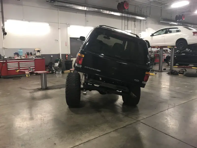

1997 Exploder with a 5.0, 4r70w, BW4406, 5.13 front and rear riding on Toyo MT 37x13.50 17 and 1993 Explorer front frame graphed in.
I wanted V8 and 4 doors, it isn’t a daily driver but if I want to drive it I can.

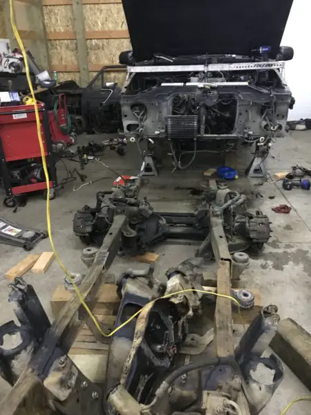

Both front frames together.

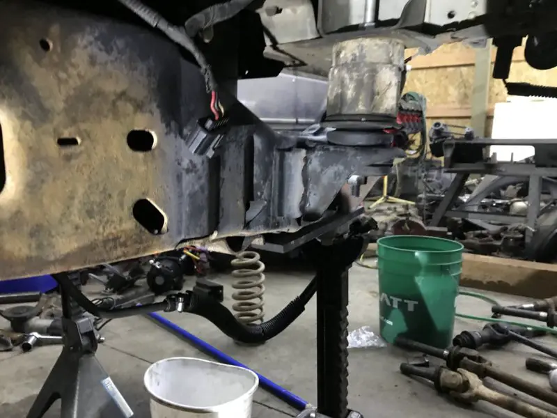

Passenger side merge, the 93’ frame is about 1” narrower and taller then the 97’ so the bolt with heat sucked it into the wider frame. Tighten both sides evenly. I notched the 93 frame to fit above/below and inside 97’. I then welded it up, grinder welds smooth and welded a 1/4 plate from the stock frame splice to the body mount bracket.

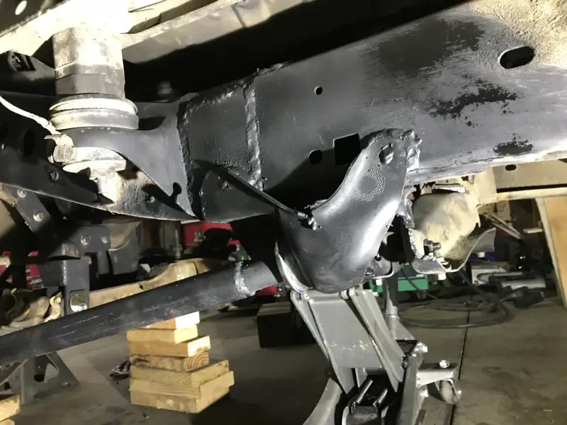

Driver side with plate, the radius arm bracket is from a bronco/f150. The center split is me torching it to bend the back ear so I can weld it to the frame. I have beefed up the radius arms since.

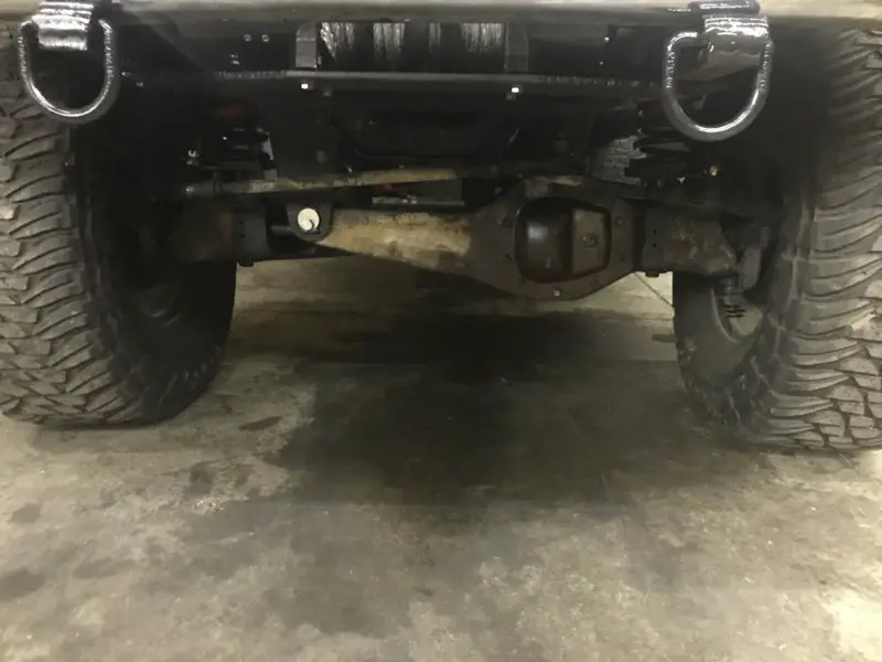

The single shock setup with stock coil bucket, the spring is from a 95 bronco 4” ranch lift spring, 435lbs an inch I believe.
Stock steering to the Dana 44 knuckles.
