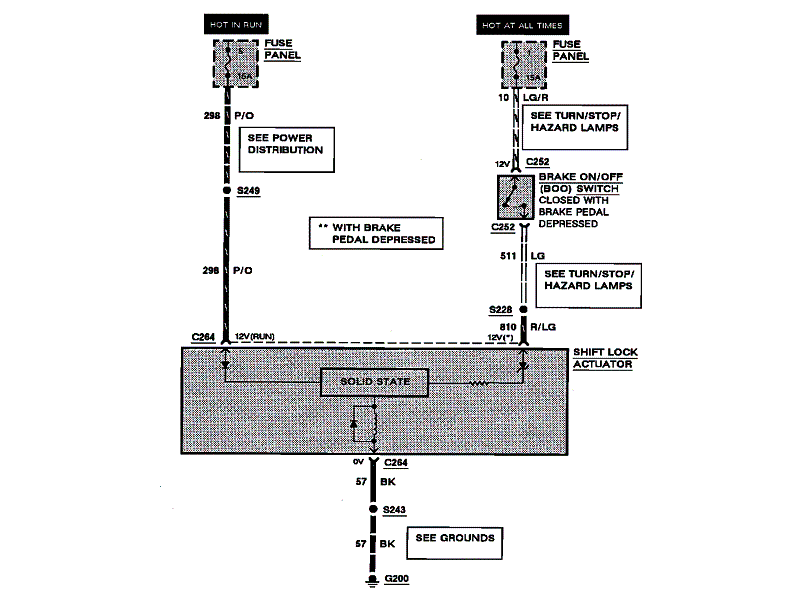

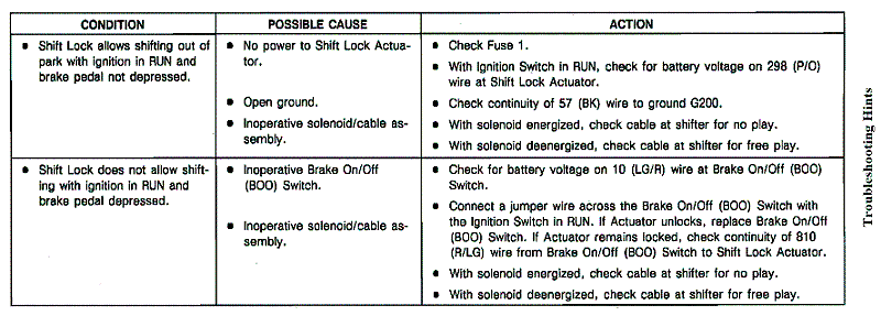

Hello I am a new member. I am from the Kansas City area. I was given a '93 aerostar, I use it for work. I have had minor problems since I've had it (2 mos.) I am currently dealing with shifting. I can not shift out of park. I replaced the brake light switch but still no luck. The brake lights do not come on either. What is the next step ? Thanks for having a free site
Well if neither work, then I'd say the switch isn't switching what it's suppose to. Follow the wiring starting at the switch, and work backward.
i have not checked the fuses, there is no cover to the fuse box so i dont know the order. i will go pull out fuses now. the guy at auto part store told me it was brake bulbs. But when headlights are on so are tail lights, but when i depress brake nothing happens
Hope this helps
