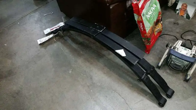

Accumulated enough Amazon points on my credit card to get these. Skyjacker FR36S 6" lift packs.
Got them installed on Friday. Looks like it might actually sit level. Hard to tell with OEM size on the rear and 35's on the front.
