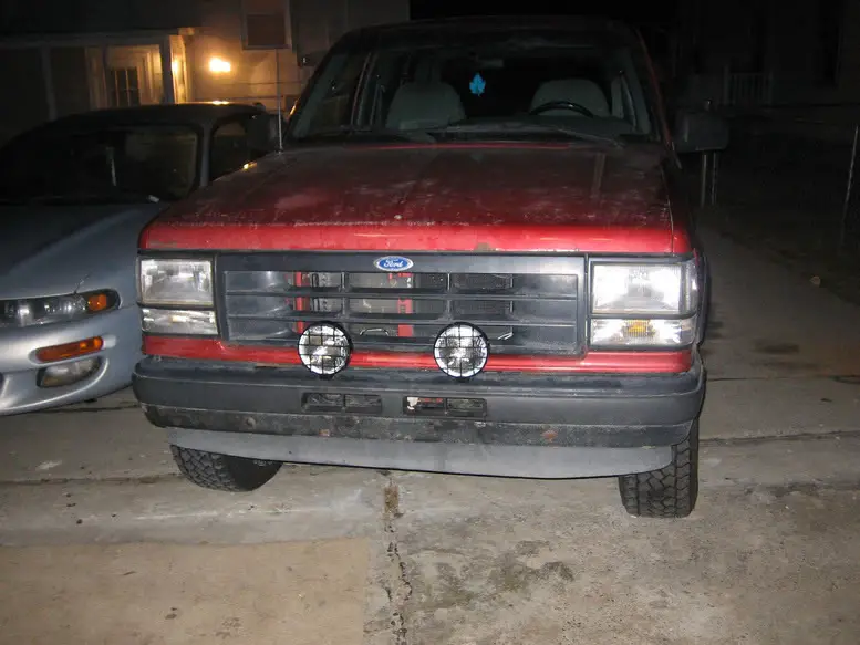

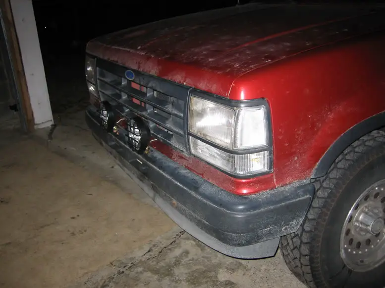

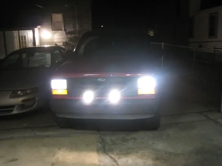

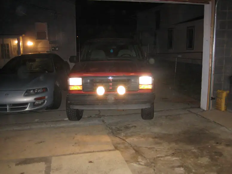

was at autozone the other day and saw some offroad lights for $40 and decided to try them out in the bumper. wasnt as hard as i thought it would be, just measured a few times and drilled 2 holes above where the opening is in the front of the bumper so i could get my hand in there for the nuts. ran the wiring through the grill to the starter solenoid and then ran the wires into the cab by drilling a hole in the firewall and mounted the switch next to the parking brake release. they work better than i thought they would.
