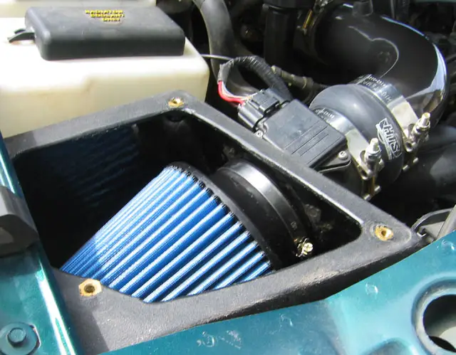

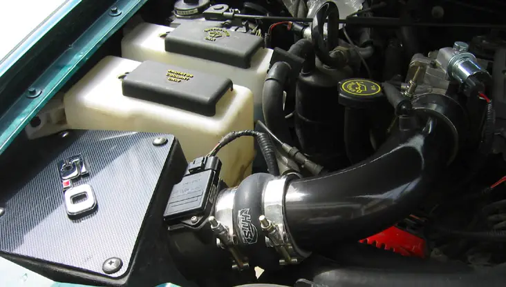

Custom air-intake setup for 2nd Gen 5.0 V8
I switched over from the SOHC V6 world to the 5.0 V8 back in November. One of my concerns was the interchangeability of my mods, most notably my Volant intake setup. I especially liked that mod and it pained me that the setup wasn't compatible with the V8 and Volant didn't make a kit available. Between getting a brand new kit from MAC or ASMI, I decided to try and make the Volant kit work. Here are the components:
-Volant filter box from SOHC 4.0 V6 kit, debadged (replaced with classic "5.0" badge).
-C&L 73mm MAF body, painted medium grey, stock OEM Ford electronics.
-Hightempsilicone couplers, stainless t-bolt clamps.
-intake tube from ASMI intake kit, painted medium grey.
-Dead Link Removed, model EaAU3560.
Here are the pics:
