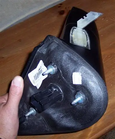

Removing puddle lights:
You do not need to remove the mirror to do this. This picture is from the Signal Mirror How To. That's why the mirror has been removed.
Keep the mirror on the Ex and insert the blade as shown, then push up and away from door and the lens will pop out. Then twist the socket out of the lens to remove the bulb.
Be very careful with the razor blade so you don't cut yourself! If you are having trouble with the razor blade then using a very thin, small screwdriver might be the way to go! Mine popped out very easily with the razor blade. That's why I suggest using it. Better to be safe than sorry.
Good luck with the fix and be sure to keep us posted. :biggthump
