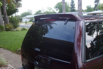

Is my Lund wing costing me mileage?
In a discussion with Jeff Draper, he pointed out that one of the biggest problems with the Explorer shape is the drag caused by the area of low pressure created at the rear of the truck. Due to the shape and it's bulk. That spoiler will deflect a good bit of air upwards, causing the low pressure area behind the explorer to be greater.
Further, Jeff, an engineer with wind tunnel experience, pointed out that one would probably get an improvement in mileage if you had a spoiler on the rear that deflected the flow downwards to fill in the area behind the vehicle with higher pressure air from over top of the vehicle.
I shall remove the wing/spoiler and do a long test drive to see what effect it has on my mileage. Then I shall investigate a spoiler that deflects airflow downwards.
Jeff, thanks for the idea.

Al, I agree with Jeff's reasoning. (I'm not an AE, but have some experience with military and civilian aircraft.) That HUGE rear hatch area has concerned me regarding aerodynamics ever since I bought mine.
The stock Ford rear air deflector is probably as good as it gets. The shape of it does deflect the airflow downwards, giving a dual purpose, to clean the window, and improve the aerodynamics. With today's CAFE standards, could Ford have possibily done wind-tunnel studies on the Explorer, when designing the rear deflector?............... Nah :)
