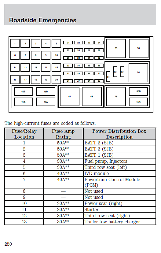

Is there a separate fuse for the rear pump ?
Wiper Washer Wiring Diagram
I don't see a specific fuse for the washers. There's only the front reservoir for both. The washer pumps are probably connected to the wiper motor fuse, which is #30 in the High Current Fuse Panel.
