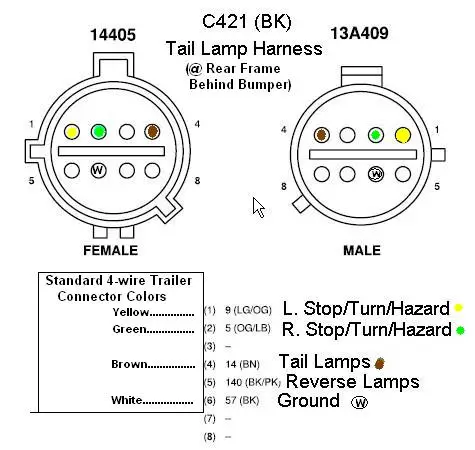

Sending you a schematic of the parking lamp circuit and the position in the Relay Box 2 of the parking lamp relay. If you replaced the headlamp switch and got your dash lamps back then your relay must be good. You must have a problem in the wiring to the rear lights themselves. Did you or did you not have front parking lamps?
Forget the brake lamps. They are completely separate circuits from the park/tail lights.

If you have front parking lamps and dash lamps then all of your switches are good. The problem will be in the harness/connectors to the rear. Did you check for power in the black connector on the left rear frame rail? BROWN WIRE

well fellas, i solved the mystery!!! i was sitting here at work racking my brain about why these damn tailights werent working, then i started looking at the diagram ranchero sent me for the taillamp harness. i didnt have my miltimeter with me but i went out to the parking lot, and started testing the lights again. the brake pedal lit the light up, and the turn signals were working, so i knew it wasnt the bulb. so i started following the plastic hose from where it connects on the rear left of the frame, to where it makes its way toward the front of the car.
then i noticed a small dent in the plastic hose. it wasnt even severed, just a dent like if a rock hit it. so i cut the plastic hose and what do i see, the yellow, green white and brown wires passing through. guess which wire was severed!? the brown one! it was like a one in a million rock shot that hit that hose and cut that one wire because the rest of them were fine. so i pulled out my trusty leather mean, and reconnected the brown wire together and taped it with box tape so i can make it through the night. im going to fix it properly in the morning but at least i know what happened and now i can get home safely tonight.
