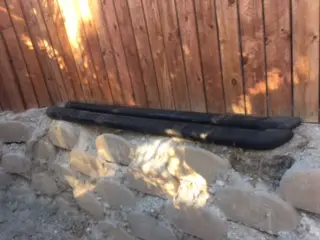

I'm not a big fan of the stock running boards that reside with my 07 ST. The plastic looks cheap and the top piece that you step on constantly pops up. I love the look of the n fab step bars but don't see anything available. Here is an example of what is available for the 03-08 expedition:
http://www.n-fab.com/products/sfID1/60/sfID2/86/sfID3/89/productID/85
I think with some minor modification I can make these work. The wheelbase of the expedition is slightly longer than my ST so some trimming would be needed. Not sure if the two steps would be positioned correctly either. I've made a similar style from scratch but was very time consuming (I didn't have 2 little girls back then). Pipe bender isn't accessible right now either. I'd rather just buy something that bolts right up. Anyone know of such a product?

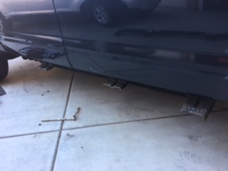

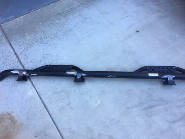

So I bought some go rhino step bars for the 04 - 08 f150 as I guessed that the position of the steps would be about the same. I guessed correct but knew the mounting points needed modification. I finally had a chance to work on the step bars this weekend.

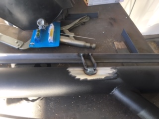

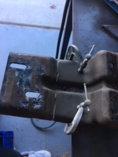

Cut the old mounts off, tack welded a jig to make sure they would line back up after repositioning.
Passenger side is near completion. Just need to weld on some spacers to the old mounting brackets to bring the main tube of the step bars up closer to the underside of the cab so that the mounts aren't easily visible. Drill some holes, check for fit, then start on driver side.
