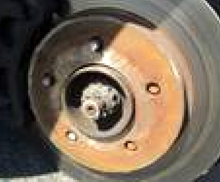

Looks like two were snapped off, or were on the verge of breaking for a long time... You can clearly see that two studs have rust on the broken off portion while the other three are rust free.

Here is an enlarged version of the image you guys seem to be focusing on.
