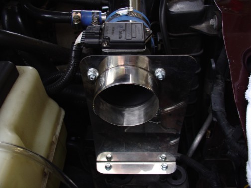

The air filter mounts to a flange on the chrome attaching bracket. The flange is "up" in the picture.
I will try to remove it and make another photo and measure later today.

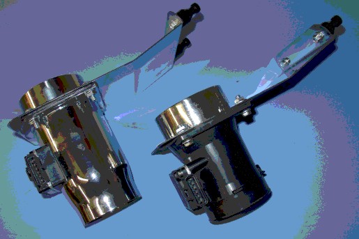

As in Dive's picture on the right (what looks like the stock MAF), that's pretty much it. The black pins at the "bottom" (far right in photo) mount in the holes left over by the stock airbox. Filter attaches at the "top" in the photo.
EDIT: Meant "right", not left. One on the left is definitely one of those overpriced aftermarket MAFs.
Thats great guys. I appreciate it. I could see the bracket and the mounts fairly well online, but had no real idea how the filter mounted. It looks like a tube welded to the bracket itself. That would not be hard to do. :)
celly said:
As in Dive's picture on the left (what looks like the stock MAF), that's pretty much it.
I do not know who "Dive" is, and the picture on the left is the Pro-M MAF not the stock MAF which is pictured on the right.

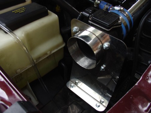

Now to answer the original question, the diameter is 3.5 inchs.
Also, here are some better pictures of the mounting flang.

The mount is very simple, the filter just slides over the flange and is held in place with a hose clamp.
