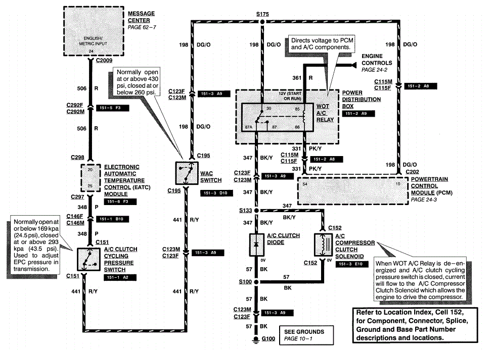

ASSUMING that this is the correct diagram for your model:Ok, so here we are today and everything is squared away with new switches, replacement o-ring, etc.
I ran the EATC self-test and got the 888.
I swapped and checked all relays and fuses. All, not just the AC ones.
I'm looking at the attached EATC diagram, starting at the top-left:
- Engine ON
- Controls set to "Max AC"
- ~14V coming into "A/C Clutch Cycling Pressure Switch", measured to ground
- Low-pressure switch is closed and passing voltage through
- ~14V coming into the "A/C high-pressure cut out switch", measured to ground
- High-pressure switch is closed and passing voltage through
- I don't know where/how to check what is getting to the PCM but its sending on the voltage to the relay so that seems OK(?)
- Tracing around the diagram through the PCM and on to the AC WOT cutout relay, at pin 85 of the relay socket, I have ~14V coming in when measured to ground
- Should I measure the voltage from pin 85 to pin 86 instead of directly to ground? (I did this and it came out the same)
- Pin 30 (to relay from fuse panel) I am reading 10-12.3V, mostly steady at 12.3V, measured to ground. That seems a little odd since everywhere else is reading 14V
- If I put in 12-14V from the battery (or anywhere else) to pin 87a (to A/C clutch), the clutch engages.
- But if I jump pin 30 to pin 87a, I get nothing.

"S" means splice or crimp -- in other words, a 3-way connection like you thought. If you have access to the EVTM book for your model, it will have a list to identify the location of those splices by number. Otherwise, I don't think that wire numbers are useful for repair purposes.Question... in reading the above wiring diagram, there's a few things I can deduce, like "C123M/C123F" is a male-female connection.
Can someone tell me what the plain numbers, like 198 or 347 mean, and also the "S144"? S144 Looks like a 3-way connection but I'm not sure what I'd be physically looking for in the truck. Thanks!
