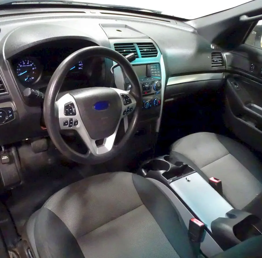

My PIU has almost 140,000 on it and nearly 3200 hours of idling. The interior is in pretty fair condition actually. I haven't seen any evidence of a partition ever being installed. It does have the holes where the mounts would go but they look factory. Washington does a good job of decommissioning, no wire mess or anything.
