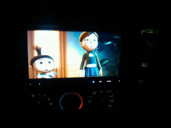

Well heres a pic of it at night, THANKS EVERYONE!!:salute:
