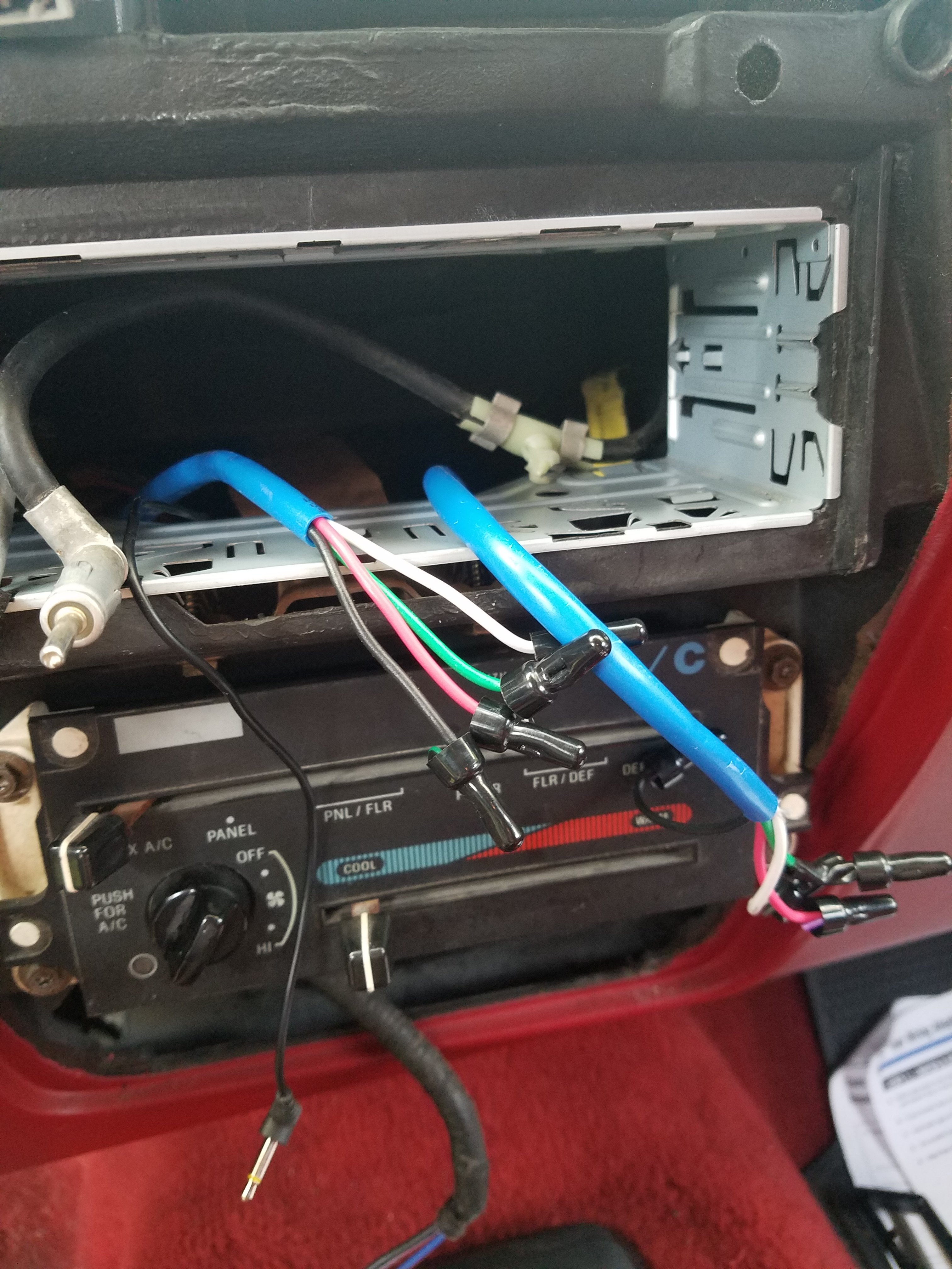

Hey all
My new to me 91 X came with an aftermarket headunit, but sound was only coming out of the front right speaker. And if i turned the volume up to a decent level it would cut out. I assumed the factory amp or headunit amp was toast. Purchased a new headunit and some 6x8 speakers.
Removed the head unit to find some interesting wiring. The 8 wire gray shielded speaker plug was unused entirely. Instead, the blue shielded wires pictured below were hooked up to the speaker wire outputs from the headunit. How was audio coming out of the front right speaker?
Okay.. next step was to bypass the factory amp.
Which on a 2 door is a huge PITA. Got in there and discovered the factory amp had been removed. And a bunch of splicing to the wiring back there. Was there a sound system that was maybe destructively removes at some point? Anyways, soldered everything back to stock and installed the bypass harness.
Went ahead and installed the same headunit adapter from the old one into the new one. Same result, sound only from the front right speaker.
Went back in, removed the blue shielded wires from the harness, and used the 8pin speaker plug adapter as specified. Double checked everything.
Reinstalled the dash and all, now i only get sound from the right rear.
I went ahead and installed a new speaker into each back seat and the same result.
Im scratching my head.. wtf is going on here?
Attached are some photos of the blue shielded wires and also of a random 2 wire connector dangling below the dash. Any idea what these are for?
Thanks in advance yall

I'm not sure if a 91 had an amp back there. The guy maybe had aftermarket speakers & just used the wiring back there to tap instead of pulling new wire. The dangling wire I think plugs into the back of the climate controls.
Okay figured out the blue shielded 4-wire bundles were used as aftermarket speaker wires.. for what reason I have no idea, they re-spliced back into the factory speaker wiring down by the scuff plate covers. I really am at a loss for words in what was going on before.. I should have taken pictures of the wiring madness but I was impatient to get things sorted.
Fixed the splicing under each scuff plate and gained my front two speakers!
Now I am down to tracing the open circuit for the rear left speaker... wish me luck yall! If I can't get it in a day or two I'll just run new wire for that one speaker.
Question, what are those holes drilled into the bottom of my dash? Am I missing something or was that were they had a CB radio or stereo amplifier mounted? I believe the car had an antenna, found another really weird connector.
