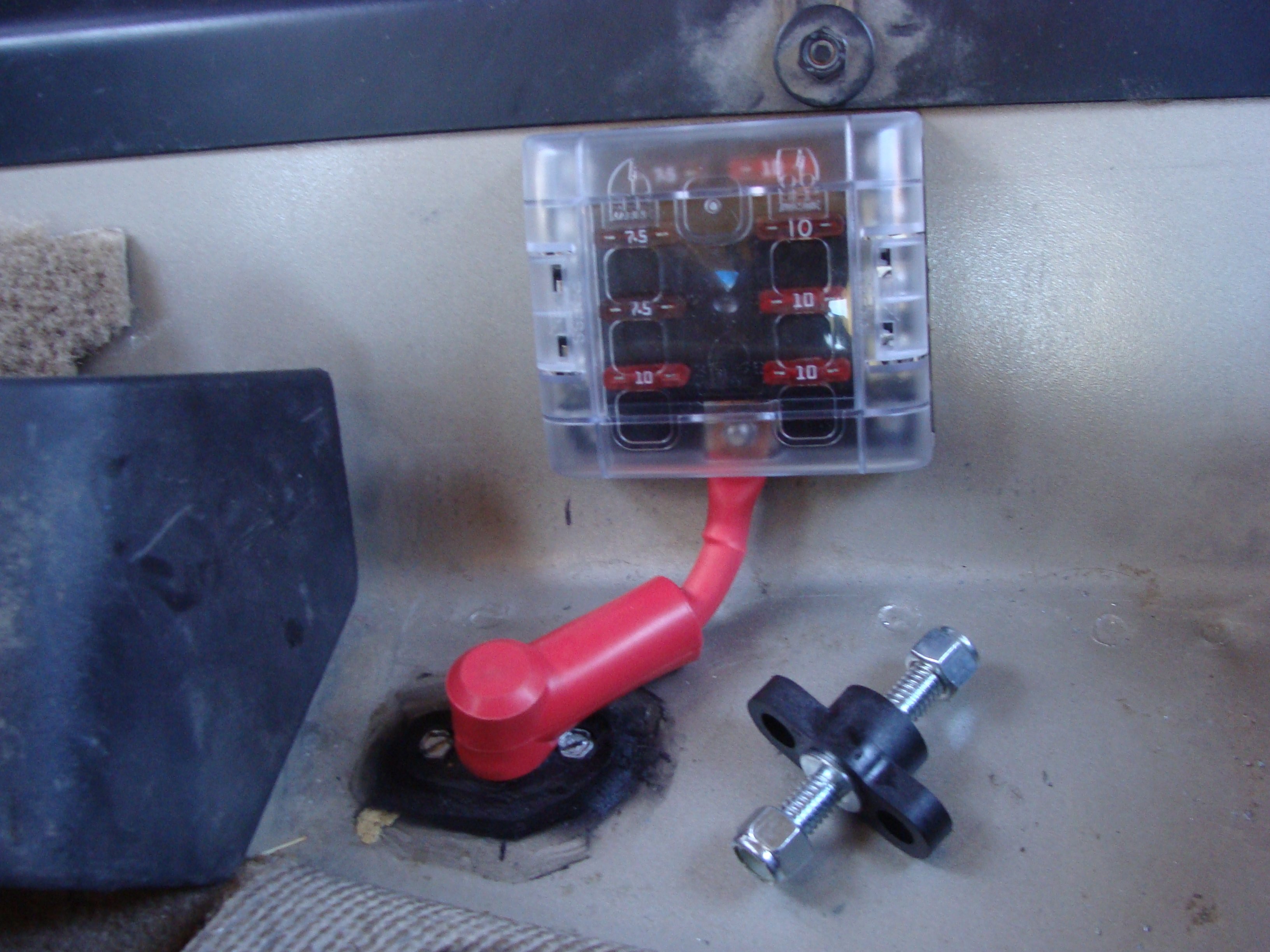

You can buy a bulkhead terminal and just run the cable along the frame to the back then come through the floor to your sub/electronics. Seal it up with some RTV and you don't have to worry about cable chafing either. I have an auxiliary battery in the back and did it this way to run power to multiple power ports and electronics I use.
