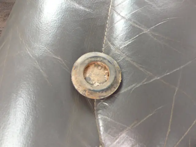

The ones I am talking about are oval shaped, maybe 1 inch long. I guess the proper term would be rubber plug. But you can punch a hole through them for your wire. I have a 400Watt Power inverter behind my driver's seat. And I power it from a wire from the power distribution box next to the battery under the body and through the rubber plug that is just behind the drivers seat(if memory serves).
Ok, I have a bad memory. It's round, not oval shaped.
Oh yeah, looking from inside the vehicle it is behind the interior, but you can see it looking up at the bottom of the truck.
Here's a picture I just took of mine. And yes, I've been driving around with most of my interior removed. I'm not looking to impress any women and it's an offroad truck. :D

john thanks for all the help you have given me and im sure everyone elce apricates it i sent u another pm i ran mine though same kinda plug thats under the dash but i think im going to re route it this way
