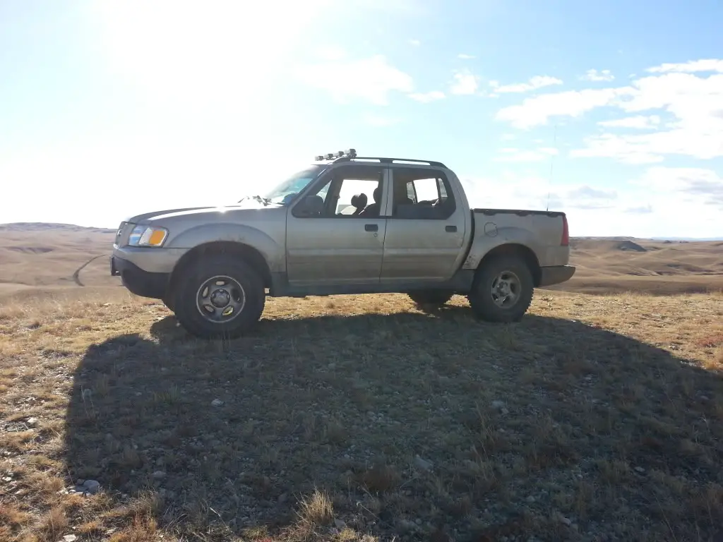

here is mine with 265/75R16 on stock wheels only rub i get is full lock on the sway bar. they fit fine with no wheel roll. i have BFG mud terrain cassings with the gaurd dog tread they are treadwrights. it hums down the road but its not over bearing.

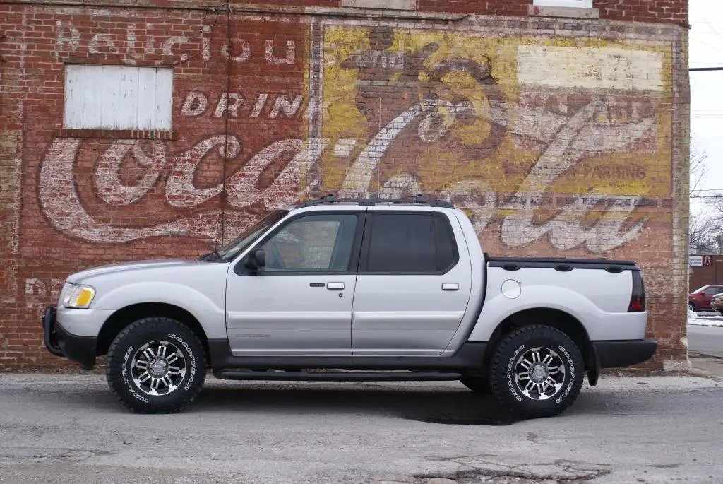

anyway, heres 265/75-16 Duratracs on Vision wheels. I have a TT and SL. No rubbing lock to lock as far as I can tell. There may be some in the rear because my springs are getting pretty saggy.
