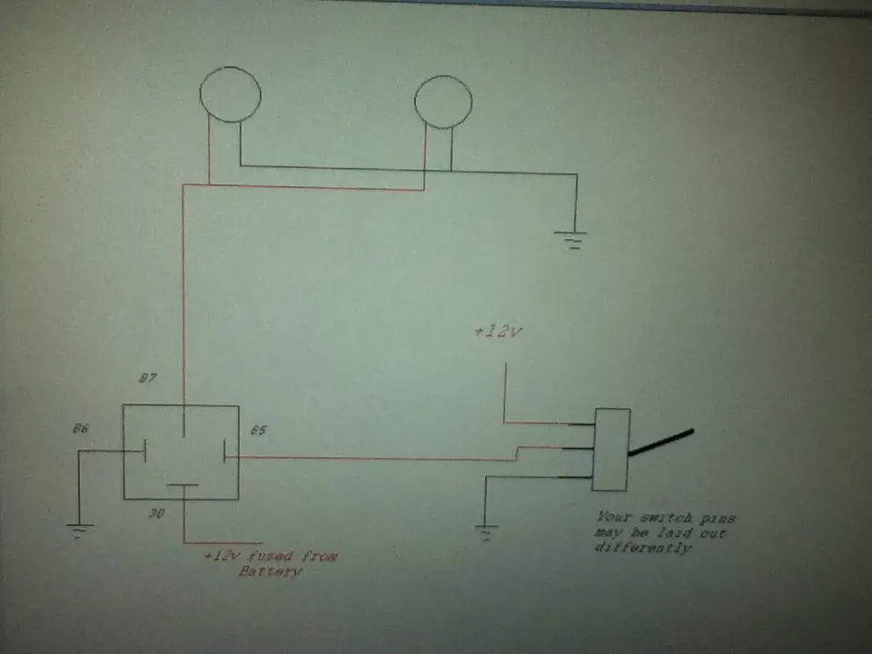

So I my dad had an extra relay in at his house and it say on it 86, 85, 30, 87 87, 12V 30A so would this relay work for a pair of the lights? And how would I wire that with it having two 87s?
Well this is how I ended up wiring my lights
