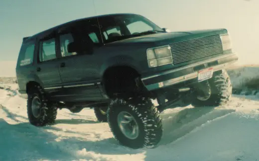

Mild off road and daily driver, huh?
Well take a look at mine. 92' Explorer XL 4 door with manual everything. IMO there the best for all around.
Even though I like the 95+ body style but I'll take the Dana 35 over a true IFS any day. It kinda comes down to you and your taste. I built mine so I can go out and do some narly trails around here but drive it to work every day of the week. Some times it breaks and sometimes it don't but thats what comes with wheelin'.
