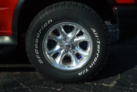

I ran 245/75/16's (30x9.65) on a stock 2dr for a while.
