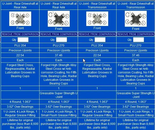

Thanks guys. I'm going to order napa part# PUJ 354. The Ford manual says that if Im going to reuse the bolts then I need to reinstall with threadlock and sealer. Is that loctite and teflon tape?
