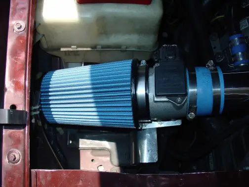

The new air filter is installed

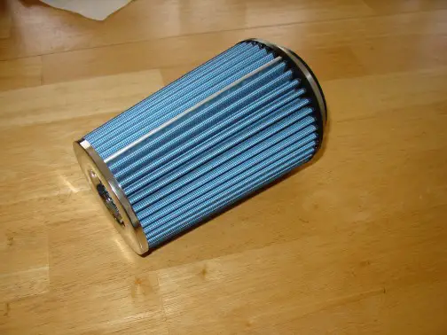

My supply of the new Amsoil EaAU Air Filters arrived today.
This new cone filter is definitely a quality product. Its features are well described at https://www.amsoil.com/storefront/eaau.aspx .

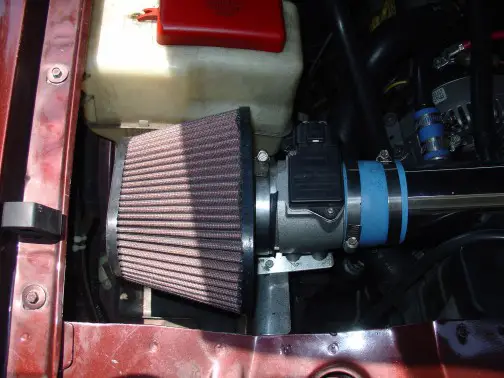

My Mac filter was just about ready for a good cleaning. Also its mounting flange was torn; most likely a result of under hood heat.
I installed the EAAU3570 filter by removing the Mac filter’s hose clamp and filter, cleaned the mating surface of my 73mm C & L MAF ( http://www.explorerforum.com/forums/showthread.php?t=136883&highlight=C&L+MAF ) and installed the new Amsoil filter and secured it with the included clamp.
A road test demonstrated no difference in intake sound as compared to the Mac filter. A trip to Atlanta next week will determine its effect on gas mileage; I don’t expect any.

Mine arrived today as well. I got the larger model with the longer flange (3560). Fits my Volant box like it was made for it. Did yours have a slight coat of oil on the flange? I was a bit puzzled about that. It looks like any other oil/cloth filter upon close inspection, but the cleaning instructions on the box suggest otherwise.
I am very impressed with the quality of construction of these new filters. The silver cap with the Amsoil logo looks very nice. Definitely not "baby blue" like I thought it would be in the photos. I've used AFE (spec'd on Volant), K&N and most recently Green. I was very impressed with the Green filters, but the Amsoil offering is definitely a step up. You can tell it's a quality product as soon as you take it out of the box and the price is better. Only time will tell if there are performance or mileage gains. In theory there should be becuase they're less restrictive and don't get clogged up as fast.
The coating on the mount flange appears to be silicone. I am sure its there to (1) protect the rubber and (2) facilitate slipping onto the MAF.

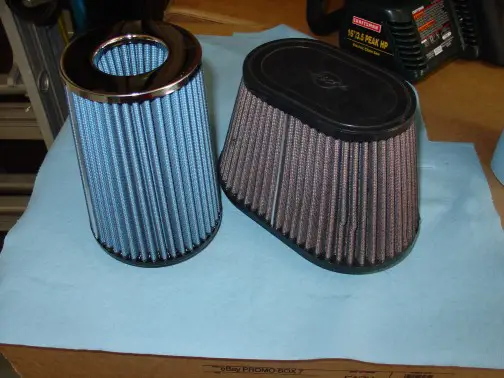

I wonder if the surface area of the AMSOIL ea filter (pictured in post #8) is about the same as the surface area of the MAC filter (also pictured in post #8)...
The AMSOIL filter looks longer, but not as wide.
The surface area appears to be about the same.

Here is a comparison pic ....

I have the MAC intake and stock MAF as of now.. so my question is will this fit my X??
Thanks
Jeremy
Thanks
Jeremy
Sure will; its fits well on mine.
