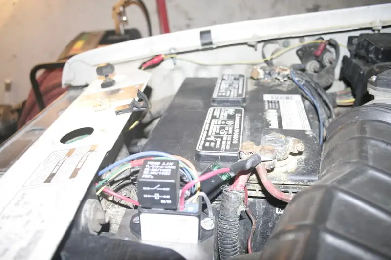

the fan has ben working great. only probs i have had was from the cheep fan controller i used kept frying. (this fan draws allot of amps.) now with the better controller all is good fan never comes on when on freeway or cold days. any body wants any pics just let me know and i will take some of what you want to see.

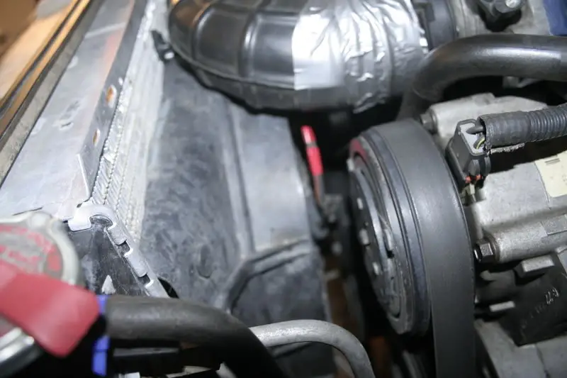

I used two straps of 1/4 steel flat stock about 3/4 inches wide and ran them vertical from the top to the bottom flanges and spaced it about 1/4 inch from the fins on the raditor. i put in a aftermarket 16 inch fan same one i see at fleet farm for about 40 bucks. installed a temp switch that is on at 205 off at 195 and wired in a relay then for the a/c I wired in another relay so the fan is on when the a/c clutch turns on. i would not use the stock shroud cuz that would be to much flex for me to feel safe with

best i could get camera needs to go to the shop:(
the controller
some of the wiring
