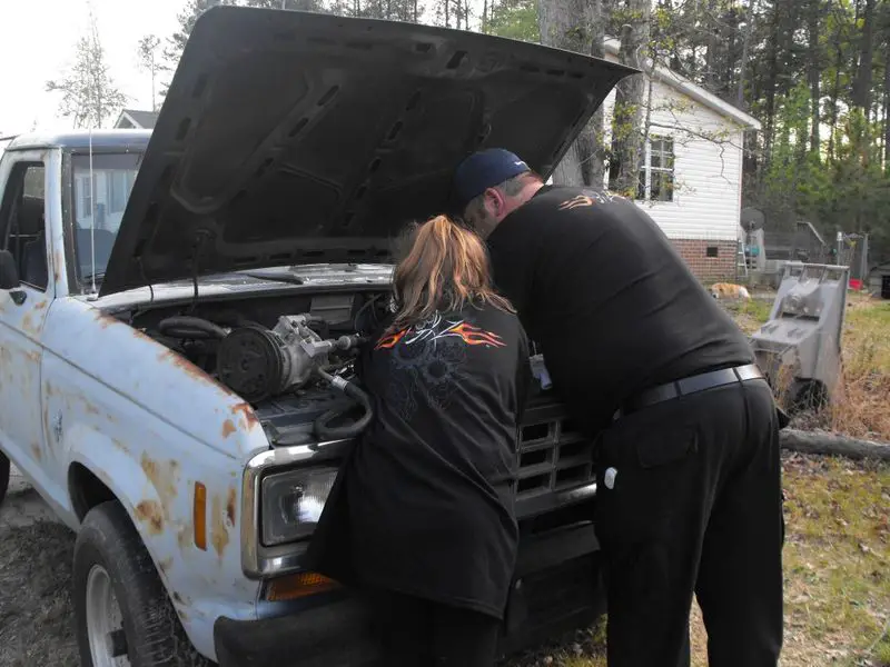

I am definitely not sorry that i bought this vehicle. even if i would have had to replace the engine myself it would still have been worth it. that's why i didn't even consider the dealers offer to take it back for a refund. it would have been stupid of me to let it go. LOL! I am really a Bronco II fan, and I looked high and low to find one in good shape. I got one earlier this year and built the engine in my front yard. When I finished it, it ran GREAT but looked rather assy. I sold it and have regretted it ever since. This Explorer is basically a Bronco II with many more creature comforts... Problem is that I probably won't be inclined to drive it through the woods as I did the B2.
Motor after I finished it:
I will miss him!
