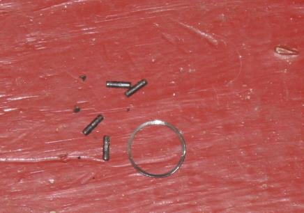

The whining noise is still there... althought not as apparent as it was before. I changed out the U-joints with no luck. I figured that might have been the problem, although it did fix other issues, i didnt fix the actual one i was going for.
