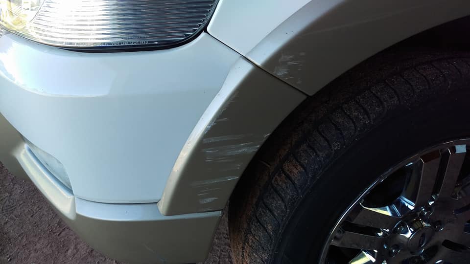

I so wish I could have found a white v8 not having that bench for row #2 is badass and would kill for that..... I got that pueblo gold that nobody makes a not expensive rattle can for paint touch up .... i found a couple websites but $20 or more for a rattle can geeze
Thanks, Motor City! My Explorer did come with a few little scrapes on the Pueblo Gold. Luckily, I was able to work most of it out with my buffer:
