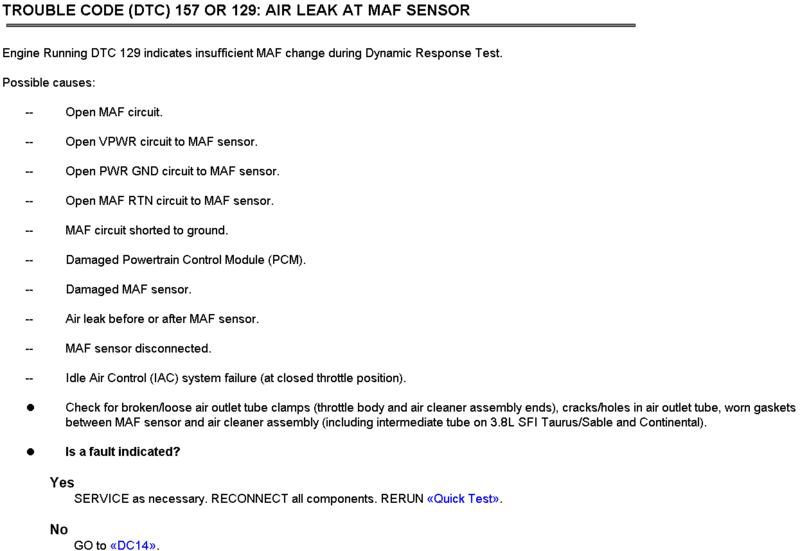

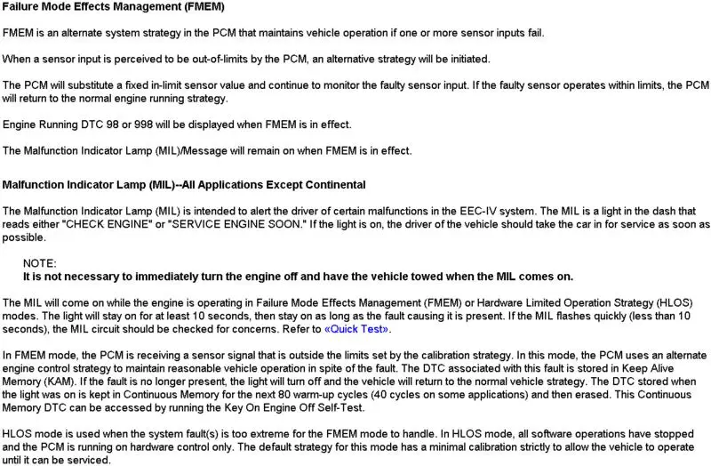

KOEO: 111
KOER: 998
CM: 157
I pulled codes before and after I swapped the MAF with the same result (cleared codes before swapping MAF).
The X still idles rough, hesitates slightly at initial acceleration, and then accelerates sluggish. I've lurked here and found all kinds of things to continue to work on, but I need some help... I'm a bit overwhelmed.
