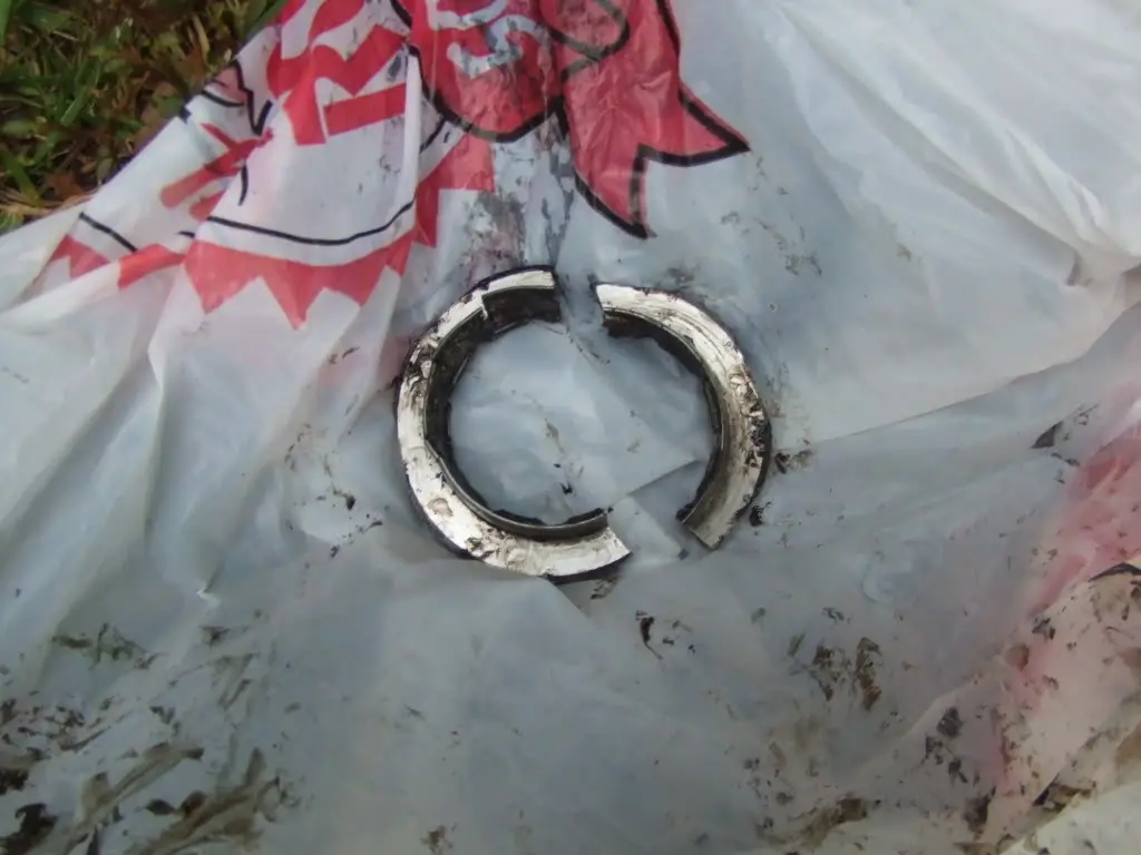

I can't get this locking key out no matter what I try. I don't have a strong magnet, and I tried fishing it out with a paper clip but the clip barely fits and the locking key seems very tight as if it is locked by the nut. Any suggestions?
You hit the nail on the head. You may need to turn the nut a hair to get the key out. Last resort, just turn the nut with the key in. The nut will crack and break and come off. Many of us have accidentally done that before.
~Mark
K, I have used some brake parts cleaner to break up the old grease. This helps but the problem is when the outside nut is torqued at 150lbs the lock ring and inner nut will also rotate and the lock ring will bite into the threads and is held with the inner nut. You bad try to see if you can move the inner nut a bit and use a pick like these to pull the lock ring off. http://www.mechanicstoolsupply.com/...ex.html_Q_Hooks_and_Picks__E_Hooks_and_Picks_
Good luck hope that helps. If the threads on the spindle are damaged too bad you will have to replace the spindle or it will not hold when put back together. I have seen a spacer used behind the inner nut to move the nuts and lock ring out a little bit so the lock ring will hold.
thats what happens when you take off the nut without taking out the key, but not always on the other side of the truck i dident remove the key either but it ended up comming off with out breaking
