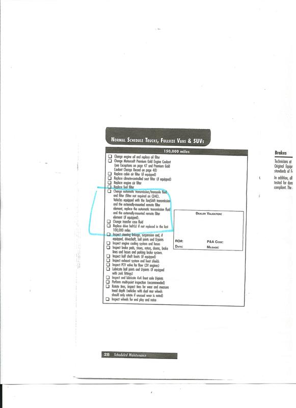

I believe the 6R80 is filled for life... can you point out where in the manual it specifies for 100k trans fluid changes?
My bad, it's in the manual on my 08 for 150k. I can scan it when I get back to the office. That being said, I seriously doubt the tranny would last that long without a fluid change and there is no way I'm going that far on fluid in a vehicle I plan to keep for a while. "Filled for life" and "lifetime fluid" are not the same thing. All that means is that you don't have a dipstick so Ford can save $5.99 on building the thing. I had a Ranger and another Sport Trac previously with the same engine and tranny and they both called for a tranny flush every 30,000 miles. Mine like most Sport Tracs has a 4.0 V6 and 5R55RE tranny. Your V8 and 6 speed auto may be different. Regardless, rare is the Ford automatic that will last much past 100k without a fluid change.

I am on BITOG and get UOA's occasionally as well. That's why I run Pennzoil Platinum with a Mobil 1 filter and change it every 7500 miles. OP wants to know how to keep his Trac running for a long time. Changing the fluids is big. Get back to me when your Trac hits 150k if you haven't had to rebuild the tranny. Like I said, the manufacturers just want to get you through the warranty period, whether that's 3/36 or 100k powertrain. After that they don't care because it isn't their money.

I will note that my manual, which is for all Ford trucks and SUV's, calls for a tranny flush every 30k on the TorqShift automatic that comes on the 3/4 ton and up trucks.
Specific to the 6R80 transmission
Fluid: Mercon LV
Fill Capacity: 12.10 qt (11.45 L)
Normal Maintenance Schedule: Transmission fluid change not necessary. Filled for life.
Severe Maintenance Schedule: Change the fluid at 150,000 mi (240,000 km) intervals.
Transmission Fluid Level Check:
NOTE: Should only need to be done if transmission starts to slip, shifts slowly or shows signs of transmission fluid leaking.
NOTE: Transmission fluid temperature must be between 175 and 185 degrees F (80 and 85 degrees C) when checking fluid level. Vehicle must be level, preferably on a hoist. Vehicle needs to be running and in PARK while checking fluid level.
1. With engine running, place transmission selector in each gear position and hold each gear for approximately 5 seconds.
2. Remove transmission fluid fill plug located on the passenger side front portion of the transmission case.
3. Separate transmission fluid level indicator from transmission fluid fill plug.
4. Wipe transmission fluid level indicator clean. Reinstall only the transmission fluid level indicator back into the transmission fluid fill plug hole to check transmission fluid level.
NOTE: Transmission fluid level must be at the upper level of the crosshatch mark. Do not overfill transmission.
5. Reattach transmission fluid level indicator to transmission fluid fill plug. Reinstall transmission fluid fill plug assembly and torque to 26 lb-ft (35 Nm).
Again, the vast majority of Sport Tracs are powered by a 4.0 V6 and 5R55RE transmission, not the V8 and 6R80 tranny. Seen too many of them go bad to risk not flushing mine.
Remember too that I am addressing OP with my answers and he has bought a used Trac with 75k on it and with used vehicles you rarely know how they were used or maintained. Did it tow a trailer? Don't know. Has the rear diff been underwater launching a boat? Don't know. Three years ago I bought a 97 Wrangler for my daughter with 132k on it. Drained the transfer case and got a 50/50 mix of ATF and water. Changed the axle lube and they were so sludged up that the automatic transmission immediately upshifted quicker with fresh lube in the axles. Just sayin'.
