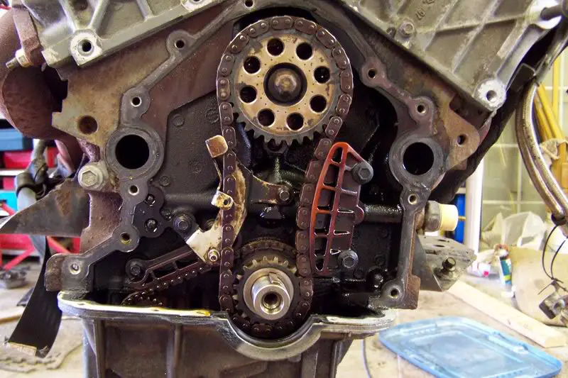

At 274K miles I predict that the primary (crankshaft to jackshaft) chain tensioner has failed and looks like the one in the photo below.
Note that the spring leaves are entirely missing. Typically the chain rattles at engine mid-range. The primary tensioner is easily replaced after removing the timing cover. Since it can be replaced without loosening any sprocket retaining bolts the camshafts don't have to be timed and no special tools are needed. I have never heard of a SOHC V6 engine being seriously damaged due to a failed primary chain tensioner. Note in the photo that even with no chain tension about 90 degrees of the crankshaft sprocket is engaged with the chain so it doesn't slip.
Also, since you have 4x4 your engine probably has a balance shaft. You may be hearing the balance shaft chain rattling instead of the camshaft chain. There's a good chance the balance shaft chain tensioner has also failed. In order to replace the entire tensioner assembly the block girdle (upper oil pan) must be removed because of the vertical mounting bolts.
As I recall the front axle must be lowered in order to remove the block girdle. In my opinion a functional balance shaft is not essential. Some members just cut the flimsy chain and remove it rather then expend the effort to remove the block girdle.

So, as I understand it, the balance shaft is only there as a harmonics dampening mechanism for the 4x4 system and the chain can simply be removed. That saves me from having to drop the upper oil pan or anything else from underneath.
I'm also inclined to agree with you that it is more likely the primary (crankshaft to jackshaft) chain tensioner that has failed. Won't really know until I get the cover off. I have an endoscope that I plan on snaking down the oil cap opening and see if I can't get a picture of it first.
