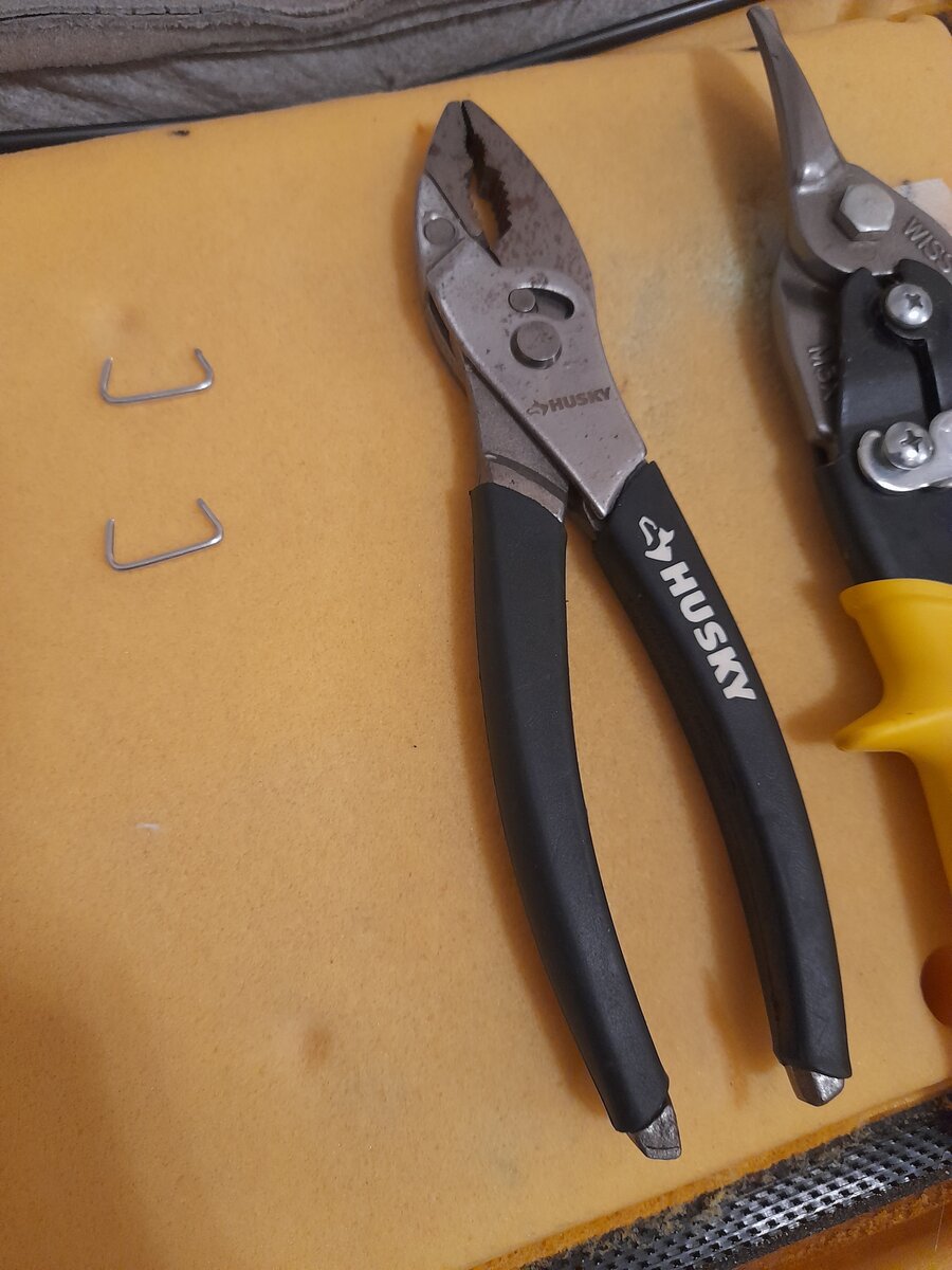

There is no need to break the rings. You only need to used wire cutters and they come right off without effort. When you put on the new skin you add the hog rings to attach it.
