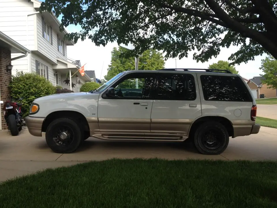

Tonight I started the plasti-dip process. Spray on flat black plasti dip on everything thats tan. IDK if I'll like it, but it peels off if I dont.

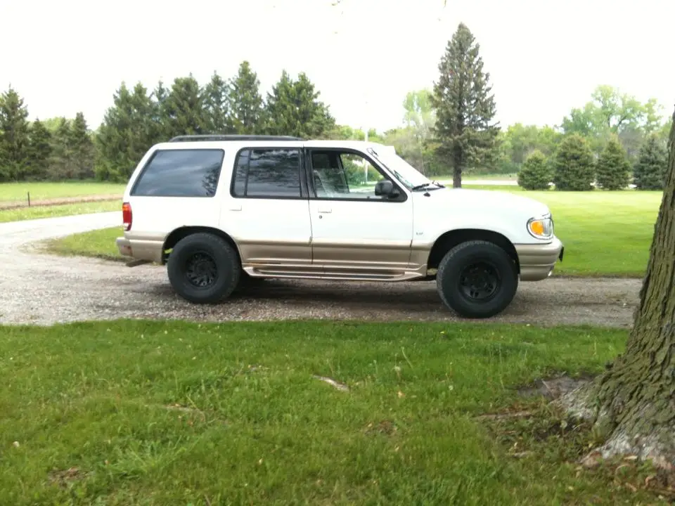

Heres a picture after I plasti-dipped the lower section that was tan:

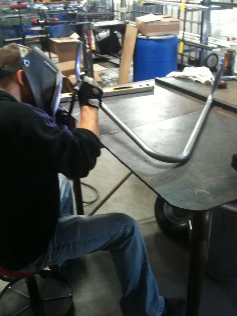

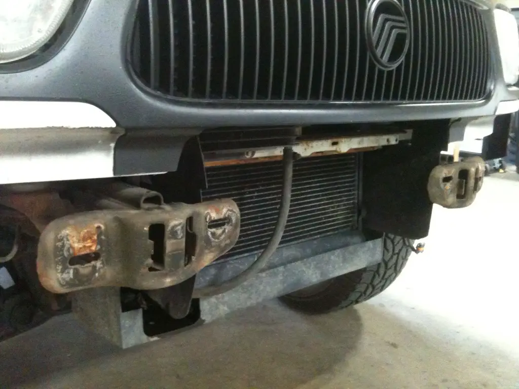

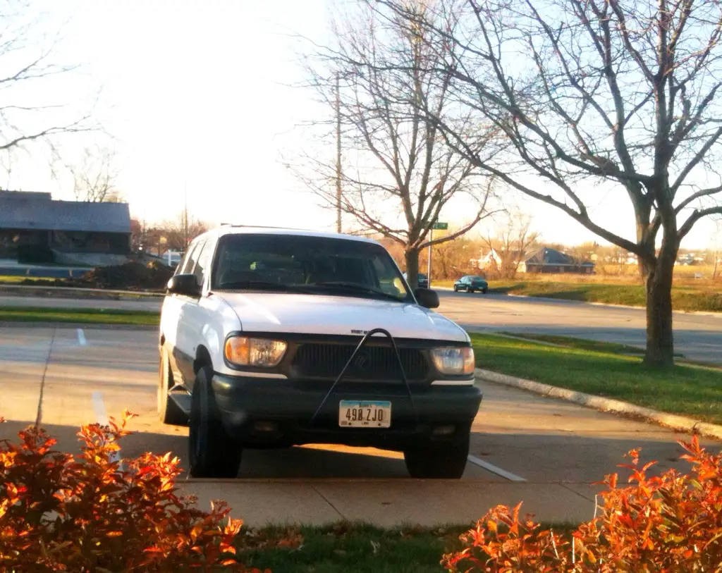

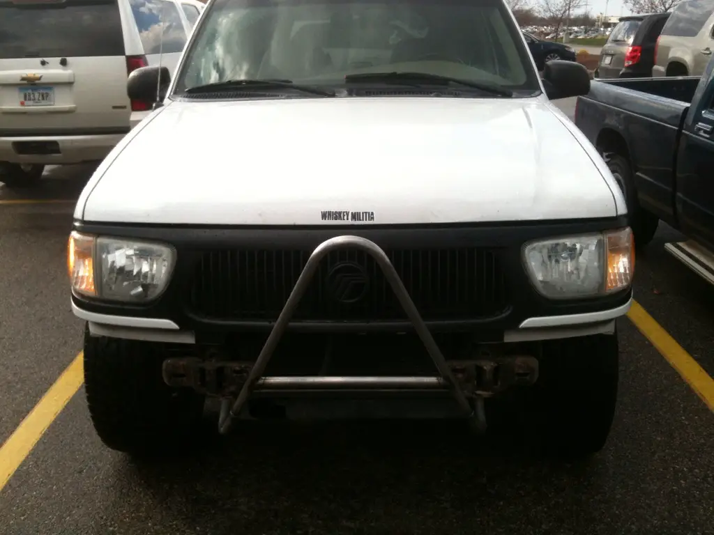

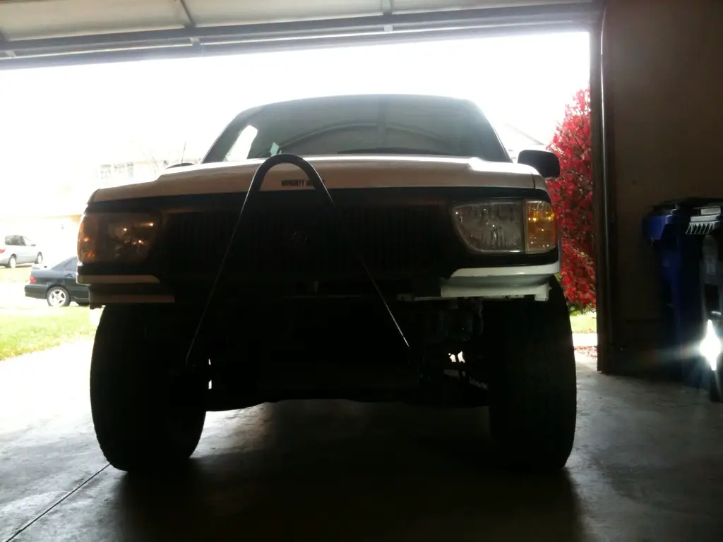

Had an idea for a small push bar and threw that together on saturday morning.
Idea is to mount it behind the bumper brackets and still utilize the factory bumper. You can see I also painted the chrome grill black.
Tig welding together 1" 16gauge
10 degree angle, coming together

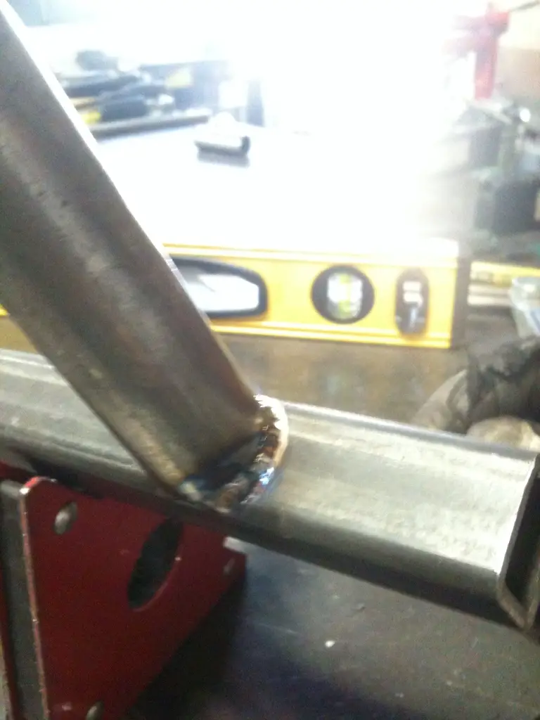

Welding the tube to square stock, and welding the square stock to the frame. Brackets would work...but this is faster.

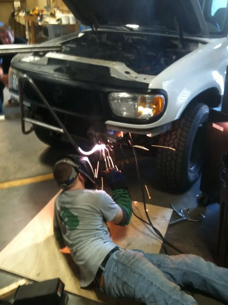

Stick welding to the frame
Completing the installation
As you can see its not incredibly strong without adding some triangulation. Which later we may go ahead and make a full custom bumper. IMO it looks better without the stock bumper on, but didnt have time to make a full bumper.

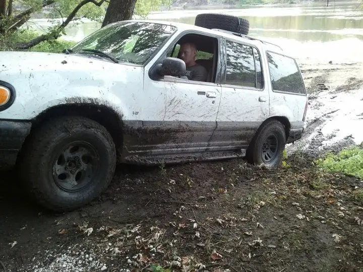

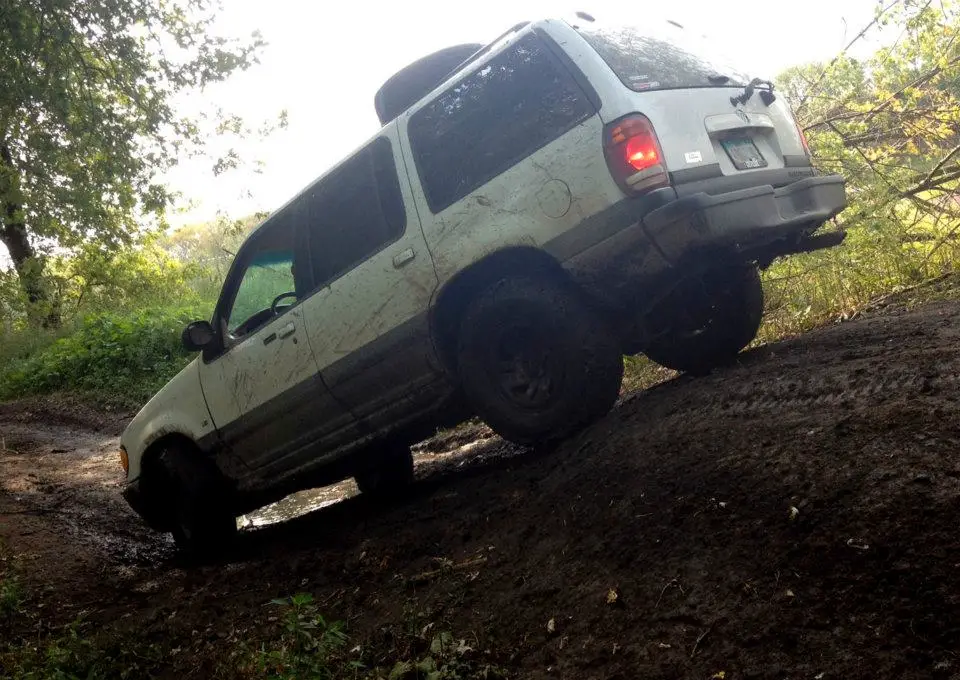

Couple shots pulling out of a river bed. Had to have a couple guys sit on the hood as I let it eat and saw'd back and forth.
And here my friend stopped at an inconvenient spot and sank a good 2 feet. I managed to pull him out, and he reattempted with significant speed and actually managed to get air born.
