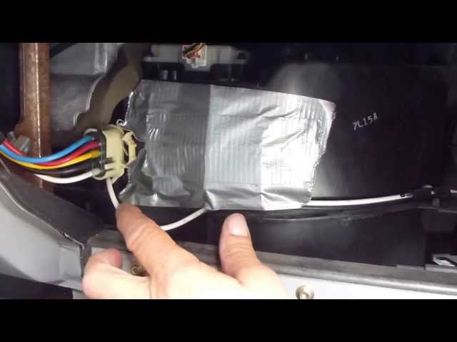

Can you post a picture of the hose you found to be the problem?
If you open & remove the glove box door there is a 1"x1" vacuum manifold with several lines in the bottom left corner of the opening. A whole bundle of different colored lines. These are your individual vacuum controls. Test each line to see if it's holding vacuum. If not, that's the line with the problem. Might have the chart for what is what around somewhere.
This thing
HERE is what I was looking for I think
