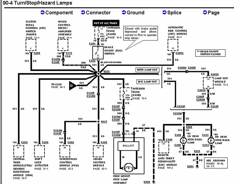

Brake lights are controlled by the BOO (Brake On/Off) switch at the brake pedal. Although there is a signal that goes to the ABS module, the rear brake lights have their own circuit from the BOO, so unplugging the ABS shouldn't affect the brake lights.
This schematic is for an 97 Explorer, but I would be very surprised if it were different for your Ranger.

The ABS should NOT affect the brake lights!
Probably the brake switch. If it is bad, it will also be difficult to shift out of park.
