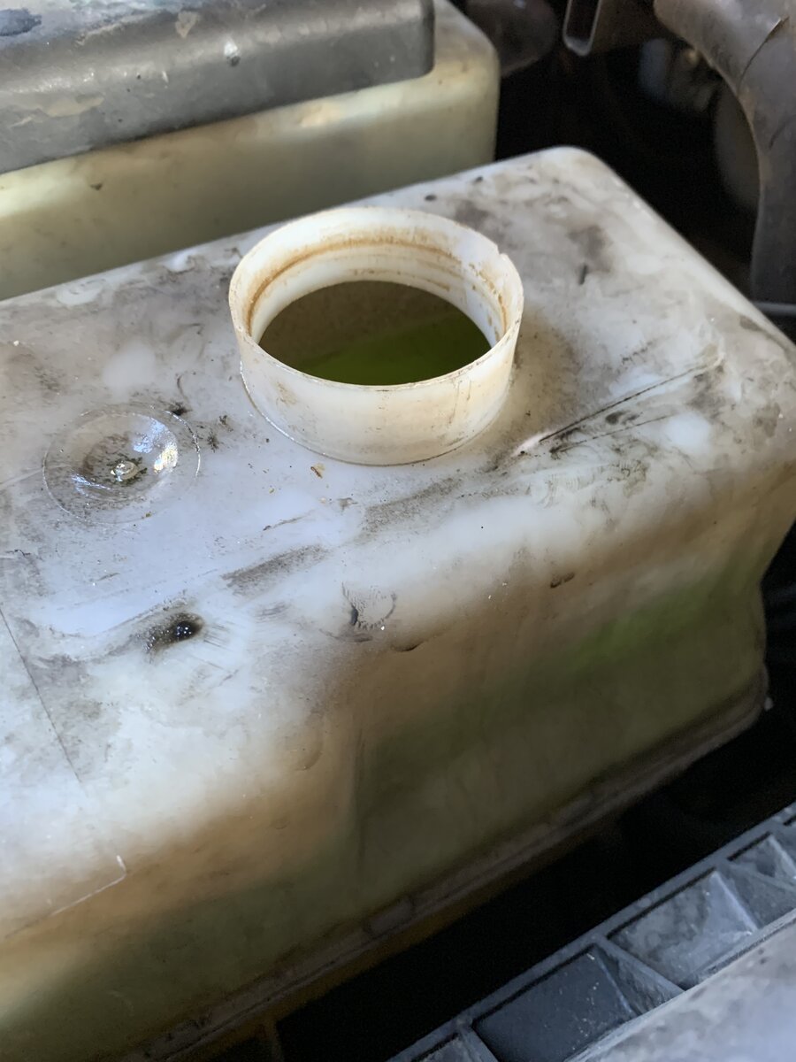

I checked the coolant reservoir today and it's empty
this is what it looks like when i open the reservoir:

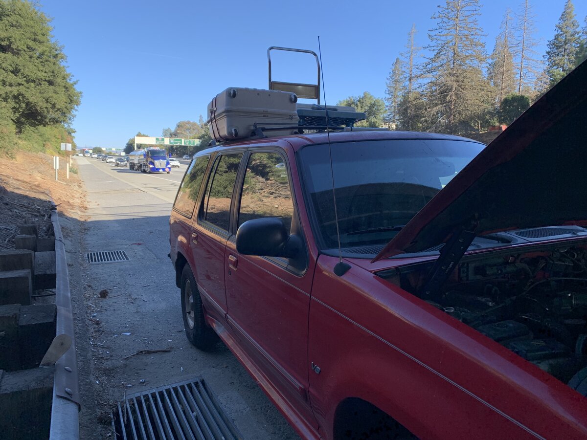

I'm sitting side of road in 100 degree heat in San Jose, CA. On a Sunday. Not good.
The water is in the radiator "box thingy" and the fan has resistance. It doesn't appear to have any milk signs in engine oil. The engine oil cap was about to blow earlier, when I opened the hood. I suck. Yes. Any helpers in the area?? Where can I get a radiator Cap if it considered malfunctioned... I'm in Santa Clara off Lawrence Expy I'll upload photos.
Or coolant?? . I put cold water in it.
